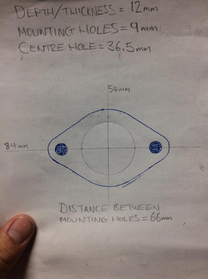

I've ordered some 90 degree 1.75"-2" silicone reducer hoses and intend on making up a straight-out but very short intake stub, it looks tight but going off rough measurements, the flexibility of the hoses should allow for enough wiggle room. Though it may mean trimming them down and I'm certain they would touch but we'll see how it goes!
So I have a 2D design for the flange plate required but my friend in the sheet metal factory has gone AWOL this week.
This design is to the spec of the original intake stub and my idea is to get a 1.75" pipe welded to it maybe only 1"-1.5" long, depending on the thickness of the pipe I go for there will likely be some overhang form the plate's centre hole, but I'll just fill it smooth with some epoxy putty/resin so it doesn't mess with the air flow.
Intake Flange.jpg (331.4 KiB) Viewed 16518 times
Intercooler, because why not.
Posted: Thu Jul 12, 2018 3:47 pm
by Growlerbearnz
Genius! Wish I'd thought of the straight inlet stub. On mine I had to replace the lower mounting bolt with a stud and nut, because the pipe is too close to the hole and you can't get a bolt in there.
Don't forget to put a bead on the end of the intake stub. The intake pipes get oily, and the silicone *will* eventually slip off if there's no bead. Something like this: https://www.amazon.com/Boesch-Built-Alu ... B0089E3KWE if you're making it from aluminium.

A really good trick is to use hairspray which will form a bond, it's a good point on the swaged lip though as to be honest I've no idea how I'll achieve that with a pipe that potentially has 3mm walls...
I may in that case have to go the aluminium/stainless route and pick up a short eBay stub then work around the inner diameter of that.
Back to ze drawing board!
