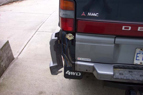

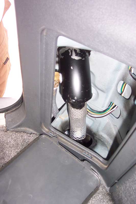

AndrewH wrote: I have yet to come up with the filler assembly, I might be leaving that to the customer as I am certain that everyone is going to prefer something different.
Thoughts?
How about this?:
http://www.delica.ca/forum/download/file.php?id=156
http://www.delica.ca/forum/download/file.php?id=155
That's how I'm hoping to do it!
I really really like that!!
really!!
Thoughts?
How about this?:
I was thinking that too but I might leave this up to the customer...
i'll keep you posted as to what the kits include regarding the filler assembly.

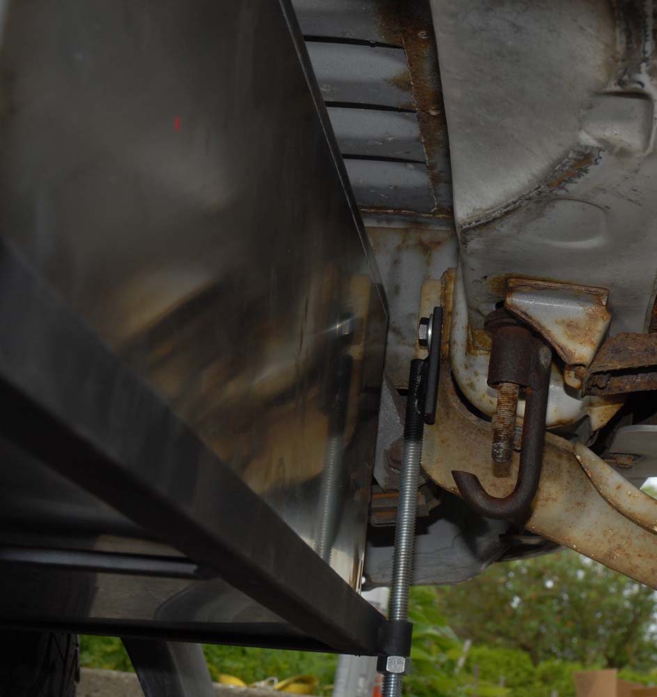

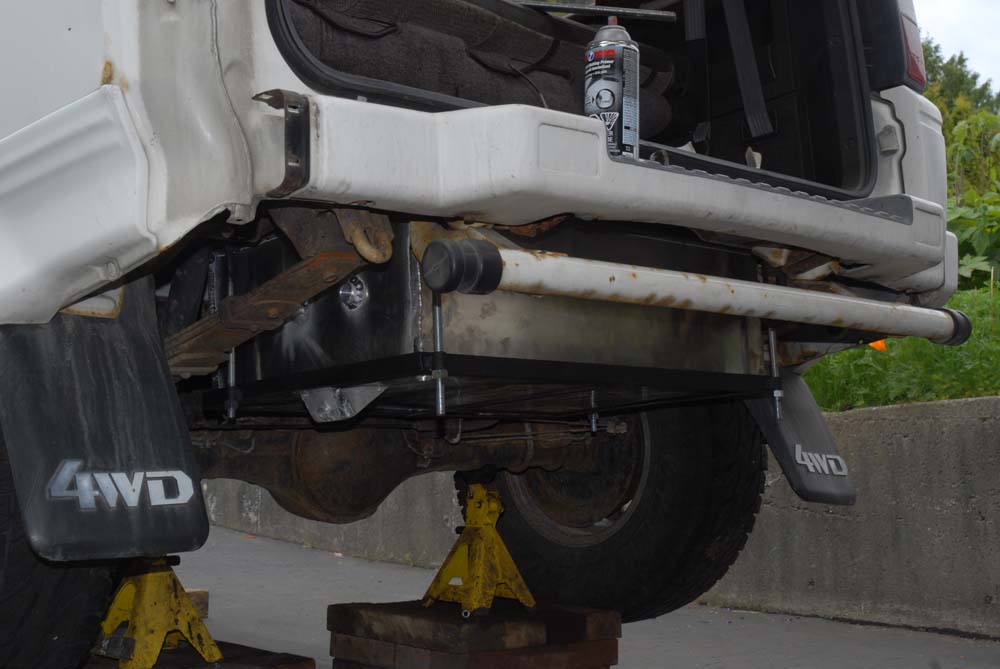

bolt in tank is done!!! well just about, need to trim the threaded bar back a little so it doesn't hang down.
20 gallons will little room a larger tank. Will take customers about 2-3 hours to do the tank install and less if you have air tools. Only tools that are required are sockets/wrench and a drill, (need to drill two holes).
Jesse this tank is 18.5" deep, not sure how you are going to fit the 23"er you have...This tank is about an inch from the e-brake cables on the rear axle and pushed pretty far back to the rear too.
I am picking up all the valves tomorrow and the filters are still on order, should have them this week.

Looks good! What's the verdict on exhaust? I can't really see in these pictures what's going on in that department on this van.
Re: Is there a market for this...Delica specific WVO kits????
Looks great Andrew. 8-)
There will be some fabricating on my part to fit mine in. Will post. :M

Seems like it would be better to have the deeper tank and then angle the bottom up as it got close to the back of the van, could get much more volume and not sacrifice the departure angle much or at all. But then again, I don't weld or make tanks so that could, for all I know, make the cost/time to prohibitive?
Adam
Posts: 848
Location: Nanaimo, BC
Post by Adam »
loki wrote:Seems like it would be better to have the deeper tank and then angle the bottom up as it got close to the back of the van, could get much more volume and not sacrifice the departure angle much or at all.
Not a bad idea, that's what Shayne (steepcreeker on the forum) went with and it gave him 114L capacity. I might go that route myself, after we build our house..... :-)
