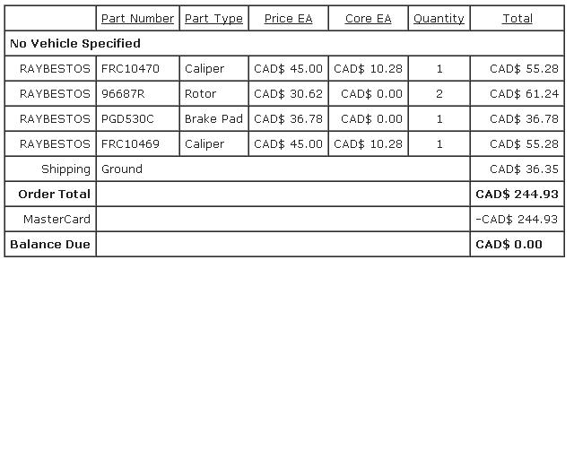

Re: Single -> Dual Piston brake upgrade + auto -> Manual hub
Well, I found the search function on Rockauto!
Their prices seem to be the best, as can be seen in the picture. Yes, you have to pay shipping, but it still costs less than Summitracing.
Everything will arrive in 2-6 days to TSB shipping in Point Roberts where I will pay a small fee to pick them up.
The total came to $244.96
subtract core charges: $10.28 x 2
subtract rebates: $15 (brake pads) $5 x 2 (rotors)
Total: $199.40 + return shipping, postage and TSB
I'll attempt to do this myself and hopefully don't run into the same trouble I had last time I tried to remove my calipers.
