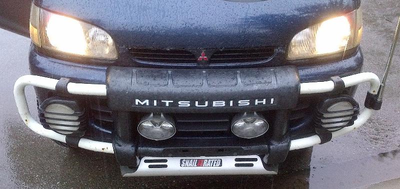

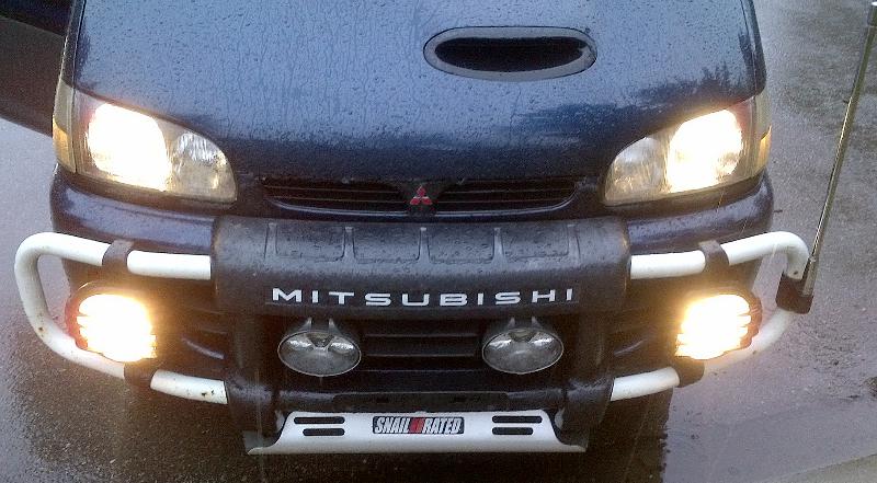

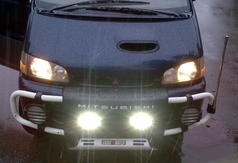

Light upgrades are cool! Especially killer LED units.
