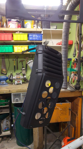

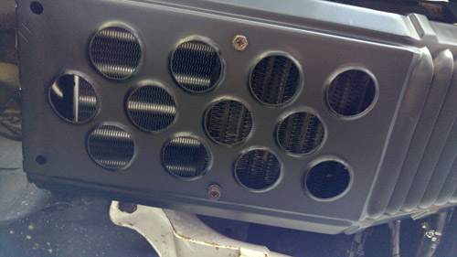

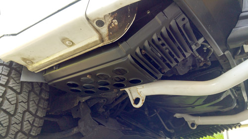

New and improved transmission cooler: the original cooler, a new, much larger one in series with it, a 7" fan on top (not pictured), all in a nice discreet box (made from the old cooler grille to keep it looking original. Ish.)

Not sure if it works yet, as my transmission temperature gauge hasn't arrived yet, but the in pipe is much hotter than the out pipe, even without the fan on.
