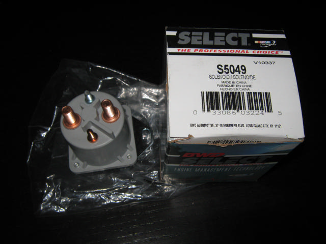

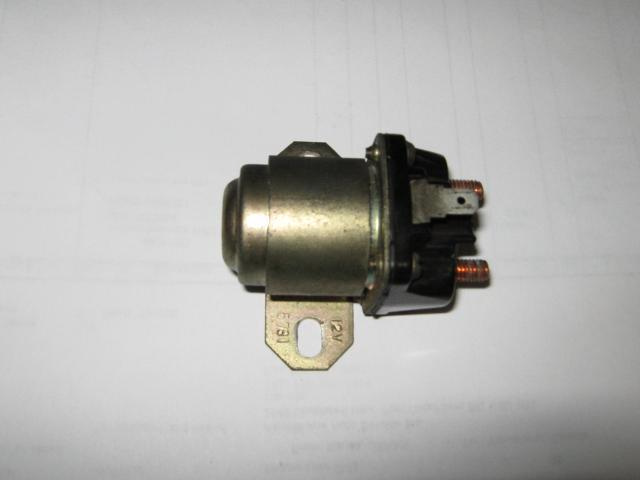

If you have a faulty glow plug relay, we strongly recommend to simply switch it with new/used one.
We have substitute parts in local part store,but you have to cut off original wires to modify as it is another hassle and not cost effective in the long run.
Bad fuel delivery cause another hard starting especially in cold weather.
Steven
