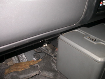

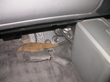

The sight glass is under the rubber gromet under the rug of the passenger side footwell. Roll the carpet back from the front
and you will see it. I have attached a couple photo's. When running with a full charge of gas it should be clear of bubbles. If
its low on gas it will look like the head on top of a glass of Guinness. Normal system pressures run around 32-34 low side
140 ish high side. Buen suerte.

Andy my friend, that is why a picture is worth a thousand word! I looked everywhere, except there of course. Found it in 2 sec's with the pictures.The sight glass is under the rubber gromet under the rug of the passenger side footwell. Roll the carpet back from the front
