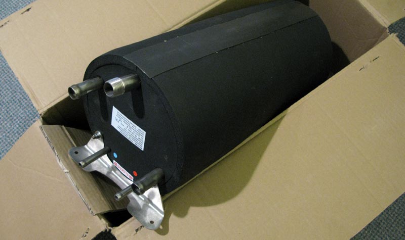

http://dinoevo.de/2011/01/hot-water-tank/madmazda wrote:i'm building a larger version in a holding tank that heats the shower water via the engine coolant
- elgena_nautic_juniorm.jpg (40 KiB) Viewed 4382 times

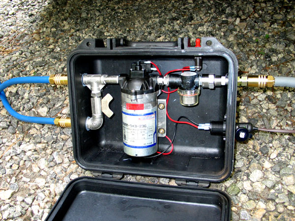

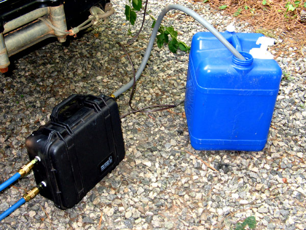

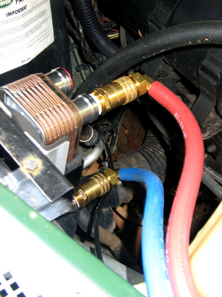

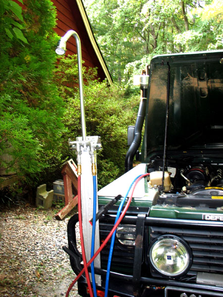

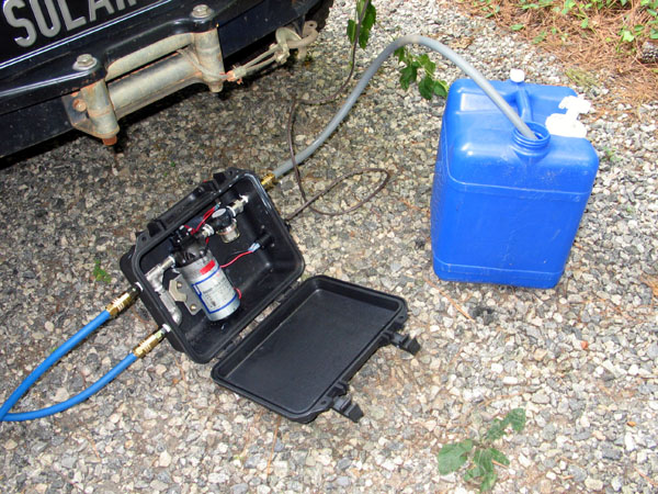

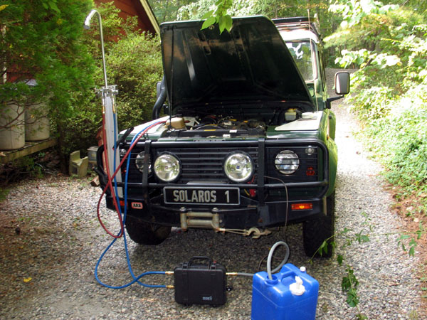

I use two 16 plate heat exchangers to have almost instant hot water via engine coolant. Each cost me $18 + shipping on ebay. $23 inline pump. $25 for shower head. $12 for fittings and $10 for hoses/clamps. Total cost was $128 for a complete hot water system that I can pull water from a creek or bucket.

Sounds cool Jesse. Any build pics? How long do you have to have the engine running to produce enough heat to get the water warm enough for a shower?
Re: Water heater
Built it for my Jeep many moons ago and took it out when I sold the rig. Have it waiting to be transplanted into the Safari.
Similar to pics below
- shower1[1].jpg (115.33 KiB) Viewed 4262 times
- shower2[1].jpg (127.16 KiB) Viewed 4262 times
- shower3[1].jpg (125.43 KiB) Viewed 4262 times
- showerbox[1].jpg (123.39 KiB) Viewed 4262 times
- shower5[1].jpg (74.45 KiB) Viewed 4262 times
- shower4[1].jpg (119.86 KiB) Viewed 4262 times
