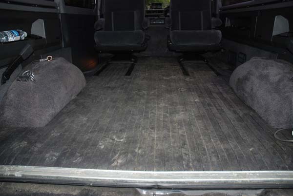

I wanted to put something inside that wasn't carpet also. I found a GMC truck rubber bed liner worked pretty well. I bought it from Lordco for $70. It was a lot of work to get it to fit right.
1. Remove all the seats.
2. Remove all the carpet.
3. Lay carpet on the bedliner and trace out the shape.
4. Then spend about 2 hours cutting out the shape. I used a knife but thinking about afterward I am wondering if a dremel would have worked.
5. Put seats back in. I left out the back row.
Here is the final result...it is a little dirty, but at least now I can clean it!
Rubber Liner.jpg (43.14 KiB) Viewed 7996 times
If you are going to do this and you buy the bed liner new I would unroll and leave it outside for a few days. I didn't do this and was pretty much stoned from the fumes for the past couple of days. The rubber smell has faded quite a bit after a couple of days.
Also because this thing is designed for a truck bed there are wheel well cut outs in the rubber mat so I had to do one little patch behind the drivers seat. That is, you can't cut it in one piece because it too narrow where the truck wheel cut out are.
