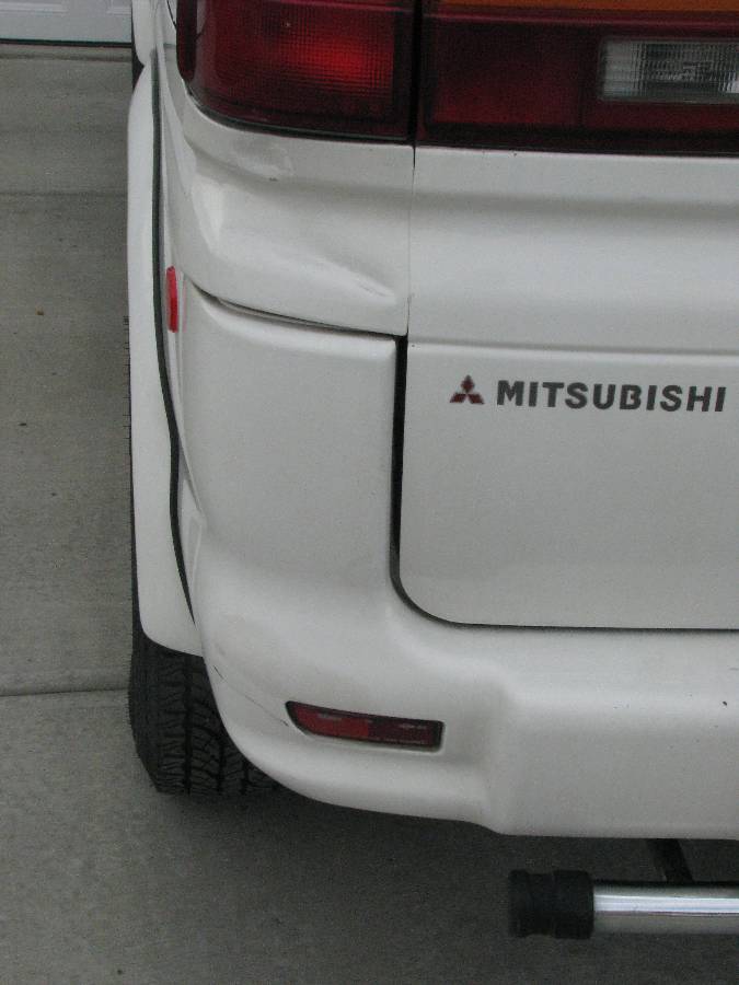

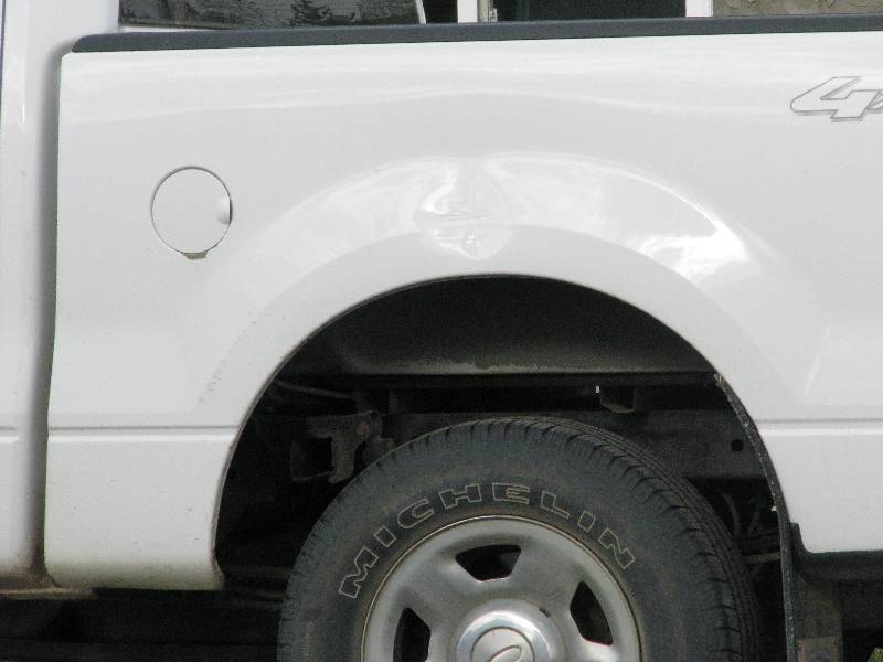

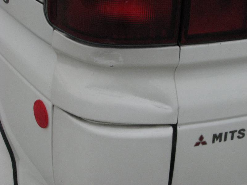

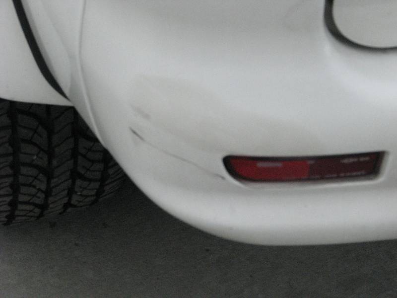

As the title states I pulled my first moron driving move today and backed into a Ford F150 today. I was lucky as far as the delica is concerned because I just got a scrape in my bumper and crunched the body panel underneath the passenger side tail light. Ford was not so lucky. So now i am going to have to spend some chingo to repair the damage I have done. The Ford is out of my league but the Delica is thankfully relatively unscathed. How hard is it to remove that panel under the tail light and does anybody have one I could buy to replace this? Color does not matter too much because I have a few things I want to get painted so I could always add that to the list. What a crappy feeling hearing the crunch. I am having a bad week.

the corner box panel on the L400 you hit is easy to remove/install and is a single piece.

Re: First bonehead Delica accident - Body panel needed
That whole panel was collapsed in. There are no pictures of my sliding door panel when it was initially damaged. Worth looking into Paintless Dent Removal. By the way, if you have the paint code for your Sophia White, then White & Peter's (auto paint supplier) should have the formula. Not sure if they operate in Alberta or not but they are a pretty big outfit so there might be one near you.

Hi, craig,
you cannot replace the corner panel.
it has a build in ribbit side corner pcs.
all you need is a heated puller that do spotweld and pull it.
the body shop has this as i work in the body shop before easy to fix just need tools and small bondo
and your done:
as per the paint code any pre 1996 to 1998 mitsubishi will do it just need to match it
hope this help
i have all the parts you need no need to buy
will help you anything i can do for you my friend
cheers;
mardy
and your done:
hope this help
cheers;
mardy

I really don't know what to do about this one. I saw the rivetted corner but I was thinking it could be cut out and just spot welded or tacked in. It is smushed in pretty good and touching the rear door and rear quarter panel because it is flattened out. I really think it would cost a lot of money to have it pulled and bondo-ed. I will have to look at it a bit more and get a shop to give me a quote. I have had a lot of people say that it is easy to take out so I was thinking that I would just swap it out. I was hoping this is true.MardyDelica wrote:Hi, craig,
