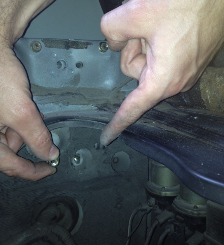

Changed my ECU and it solved my tandem glow plug & headlights clicking on and off, on and off again issue while driving. History was both my glow plugs and headlights in tandem were going on and off etc. so it sounded like a fried ECU circuit or a wiring problem. If anyone else has this issue here is how you fix:
1) Get a new ECU from one of the dealers
2) The ECU is against the wall between the passenger door and sliding door, oppisite the gas cap for a reference.
3) Pull off the strip on the passenger side door, pull off the plastic shroud on the wall.
4) Unbolt the seatbelt mount bolt. there is one on the outside and one on the inside once you pull off the plastic shround. Undo the second bolt behind the plastic shroud. Pull the seatbelt out of the way. You will see the
ECU inside the wall.
5) Open the door over the opening behind the passendger side seat which gives you access to the air intake and top of air filter. There is one plastic pipe that is bolted to the wall by a (~10mm?) bolt that you will have to undo then pipe pulls out. Next there are three 10mm bolts that hold the ECU to the wall (see picture below where I am pointing at bottom third bolt) make sure not to drop them. Once undone, pull the ECU out, unclip the wires, insert into the new ECU and do everything in reverse. Drive and cross your fingers that your problem is solved.
