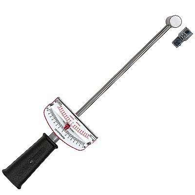

The bendable beam torque wrenches (the cheaper style) are generally more accurate then the $250+ clicker style. Simple design, no reliance on parts that fail. Most people calibrate the expensive wrenches with a beam style.
Just make sure you read them square on and float the handle....

Re: Torque Wrench
A Craftsman Beam type will be just as accurate as the $200+ clicker style and need no calibration in its future.
The reason the mechanics stop using them is they take more time to use and are much harder to use in tight places since you need to see the gauge to read it. Lots of mechanics cannot be bothered to use a torque wrench (no offence to mechanics meant).
You need to have a few with torques within the range you want (even with the clicker). Every motor I have ever built or changed a head gasket in has been torqued using beam type torque wrench. Never ever blown a head gasket or had motor come appart. Mains, connecting rods, head bolts, water pump, bell housing (if the motor and tranny going in together) all done with beam type. My friend that built motors always torqued with a beam type. His motors saw 8,500 - 9,000 RPM all day SBC...Never a problem other then the odd valve that dropped!
