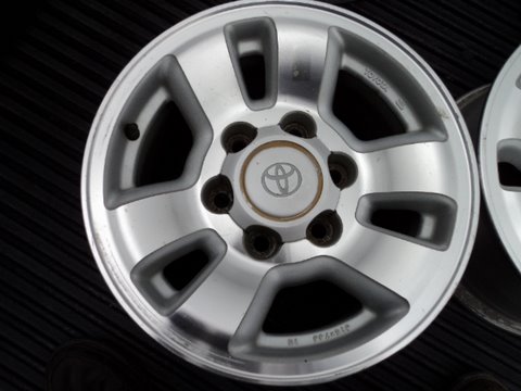

I recently acquired some sweet Toyota Tacoma 15x7 rims and was wondering a few things. The rims appear to be the same as what Delicat put on his van, and painted black.
I even have the same tires as Delicat 30x9.5R15 BFGs.
My van cam with aftermarket rimsm (15x6), so I am not sure how they compare with original. They are pretty beat up and oxidized so I want to replace them.
I think my van might have a small lift but I am not sure. I only have liquidmonkey's van to compare to.
So, I know they will bolt on (bolt centric), but do I have to modify anything?
Here is the rim.

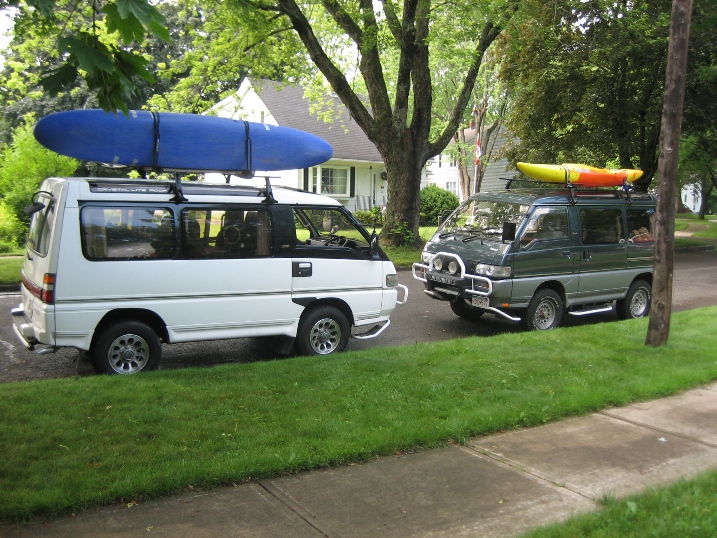

Here is my van (the green one) with Liquidmonkey's machine too.
campobello delica dorkout 001 resize.jpg (263.45 KiB) Viewed 6315 times

By the way, that pic is of the first "official" eastern Deli-meet. We drove from Fredericton to Campobello island, through Maine, for a some lobster and a kayak to look for whales.
Salmo

As far as i can tell, these Toyota rims have an additional half inch backspace than my current rims. I guess that means that the rim will be a half inch wider on each side. Since i am not changing the tire size, i can't imagine that the tire would sit much wider than it does now on the 15x6 rims.
Gonna take the $80 gamble and have the local shop put them on.

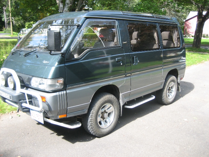

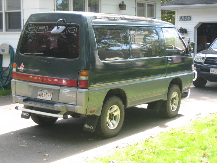

Here are a few pics of the new wheels. Again, they are tacoma 15x7 rims, probly off a 2001-2004, I am guessing.
delica rims.jpg (244.17 KiB) Viewed 6128 times
delica rims2.jpg (200.58 KiB) Viewed 6128 times
