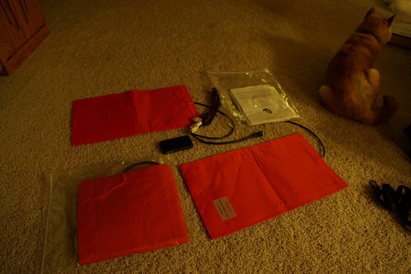

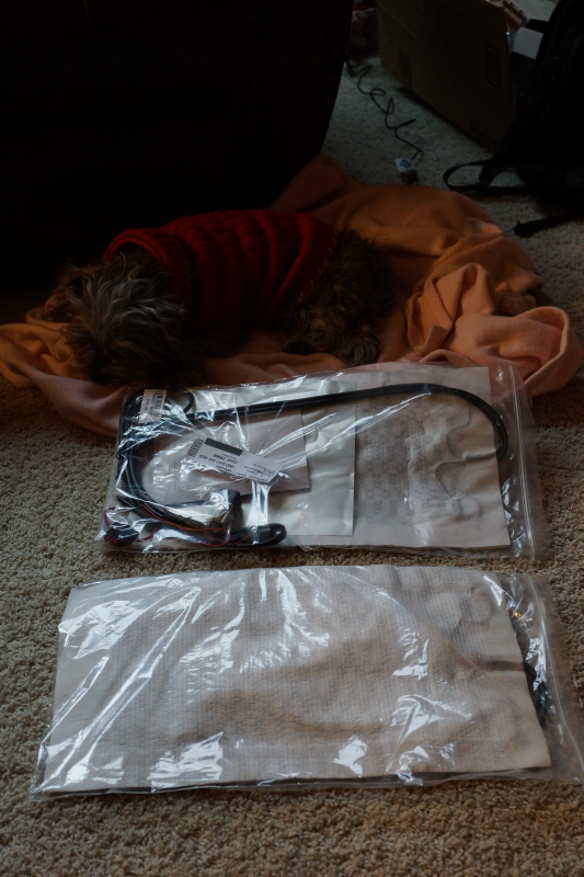

Daisy, lying on a heated dog pad (covered in blanket) next to the two packages from Amazon. Each package contains both a lumbar and butt pad, as well as all the wiring.
Daisy the Adorable Schnorkie (weighing in at 11 lbs) is here for ultra cuteness and scale. Not that you have any idea how tiny a schnorkie actually is.

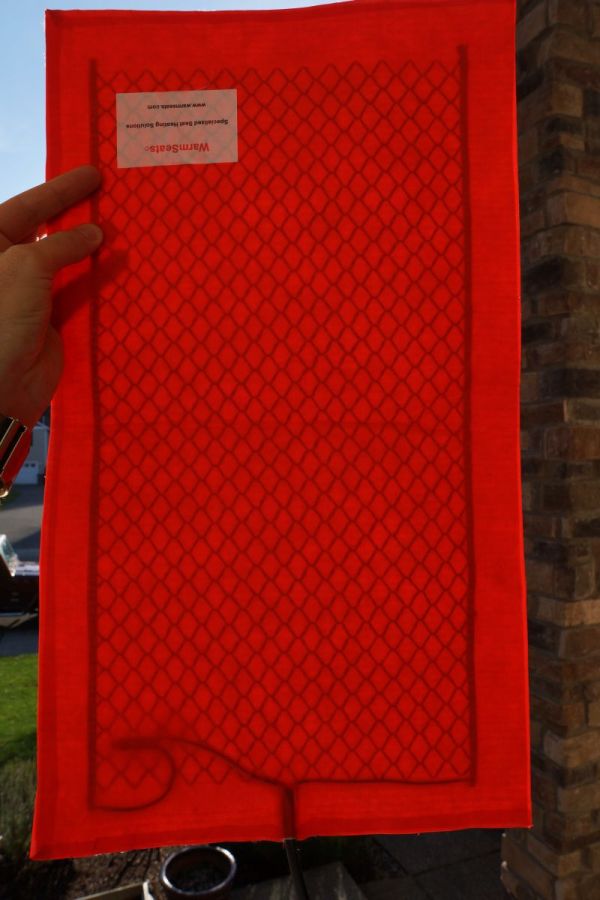

Here is a "waterproofed" seat element held up against the sunlight so you can see the carbon filaments inside it. Also the temp sensor and the "rails" running up each side. Those rails are important. You do *NOT* want to cut those unless you are shortening the total length of the heated seat.
To be honest, I think that the non waterproofed elements were a much better value.
Notice in the bottom left of this photo the temp sensor that will cut off the power if your seats are too hot, I install this part at the back of the seats where they curve so you don't end up sitting on it or having it in your back. It is the only part of the seats that is "bulky" and that you might notice if you felt the seat with your hand.

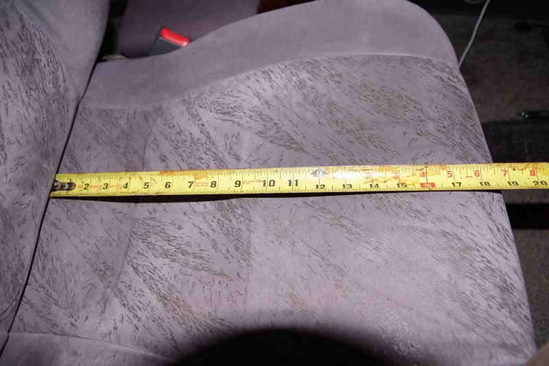

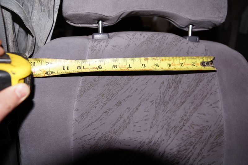

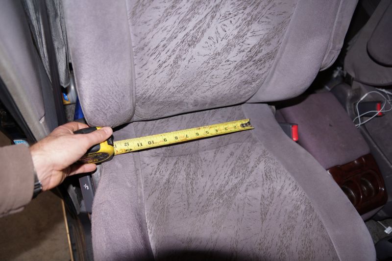

Before you actually order your seat pads, you need to MEASURE the seats. the most important part is to measure the interior fabric piece at the narrowest point. You do not want your seat elements to be wider than this ridge, if they are, they won't work as you will have to cut them, and that will cut the "rails" and then you won't have any heat!
Measure the width of the center piece of fabric in your seats. THIS IS VERY IMPORTANT TO DO BEFORE ORDERING THE SEAT PADS!
Finally, of course, you want to measure the length of the seats, this I think you can figure out without the photo, but I put it here anyways.
How long?
How long?
IMPORTANT NOTE!
Measure both the seat and seat back in this manner!
