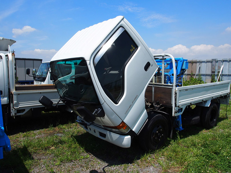

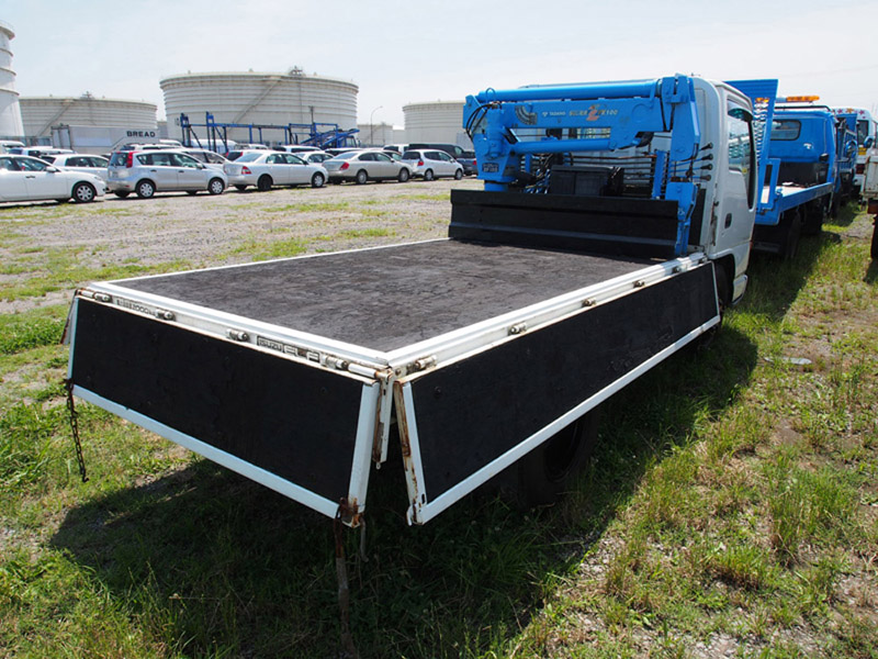

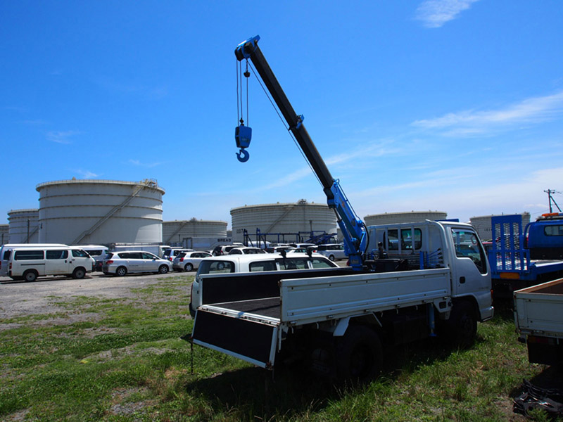

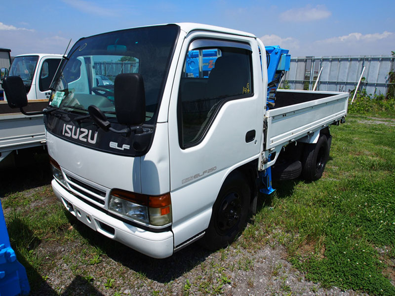

Hi After Oil,
My crane truck just landed last week! I too am tired of lifting stuff by hand, so I decided to get one of these nifty little rigs. Fold down sides, flatdeck, 4300 cc non-turbo diesel, 24V electrical, cab forward, duallies, OHC that's gear driven so no need to change the timing belt or chain. It's not a Canter though. After meeting some crane truck owners in town (Metro Van) and talking to CVI about which trucks are the most reliable, I ended up choosing an Isuzu ELF, model NKR66. Isuzu also makes the NPR series which is good too. Ask your agent to get a pre-inspection to make sure that you get 16" rims, not 15.5" or 16.5" or some other weird size, also try to avoid getting split rims. Would have been nice to get a steel flatdeck, instead it's the stock plywood that needs to be replaced, no big deal.
Here are the stats:
1997 Isuzu Elf Diesel
2.0 ton capacity
Tadano 3-stage crane
4.3 liter diesel, Engine code 4HF1
Grade 4
Interior C
Exterior C
81,739 km
5sp, AC, PS, PW
Left side power mirror
Almost new Yokohama tires
I'll PM you the price.

Looks like a sweet truck
Is that a 4x4? Does a truck like that need to be 4X4?

There are 4WD versions of the same model, but they are very expensive and extremely rare. Expect to pay double that of a 2WD. I was told by other owners that if you do park the truck downhill on a slippery grassy slope without a load on the back, you might get stuck! I plan to install a big winch behind the cab in order to haul logs up onto the deck. Also going to put some spotlights under the bar pointing backwards. Still need to find a 24V stereo though...
