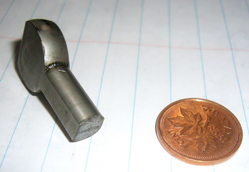

I Posted also in the Aussie club and I got this answer "yes the transfer stick can pop out of the gate. And yes the transfer stick has also been known to snap the ball off at the bottom if it gets handled roughly. The quick fix is to remove the shift knob, then the boot around the stick then undo the bolts holding the plate onto the transfer assembly and withdraw the lot. If it's broken the ball off you'll need a new stick or a good welder and a magnet to lift the broken piece out, if it's only popped out simply put it back in the gate and reverse the disassembly steps."
I worked on it this morning and the ball was broken. I did move the slider with a big screw driver to AWD. Now i need to find a used or new stick.
This piece look like is been built weak.
Claude

That is crazy weak!claude wrote:Thanks Mr Flibble.
This piece look like is been built weak.![]()

So far no luck to find a Super 4WD selector lever stick.
I am thinking to if is possible to get it weld I wonder if anyone knows a good welder or do welding.

Does the diameter need to be so small? would it work if the shaft diameter was bigger?
If yes I would find a piece of tube that just fits over it (even if you have to drill the diameter up). Metal supermarket sells cut off scrap with lots to choice from.
It should be an easy weld if you could sleeve it and would fix the issue in the future...plus it would be an improvement in design.

Great idea! I think it would be Ok if the diameter is bigger only the ball fit in a slot . I will have to wait until I go down in the big city to find such a item. No much choice in Gold Bridge.thedjjack wrote:Does the diameter need to be so small? would it work if the shaft diameter was bigger?
Thank a bunch!

I am in Nanaimo or I would offer to weld it for you
You could also find a pipe close and split it then you could get some more weld in there (should not need it)
Best of luck
