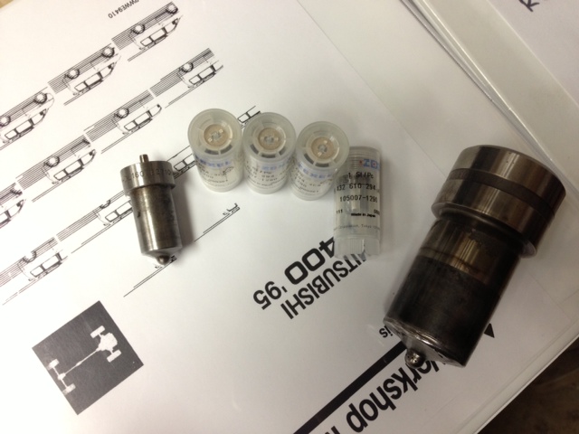

So after searching for the "official" part numbers for the 1994-1996 4M-40 (non electronic fuel pump), fuel injector nozzles, the search is over and I am posting the info for anyone in need. Please re-direct this thread to the appropriate folder if it is not the right place.
ZEXEL DN10 PDN129 is the number engraved on the nozzle itself but this most likely will not help when ordering. The number you will need to quote is 105007-1290.
I picked up 4 nozzles yesterday from a local fuel injection supplier, no hassles and for a good price. The only catch is you must be able to install to your old bodies as well as pop test and set them using shims if necessary. If you have the ability to do this then you will save some money.
If this is old news and have been posted before, disregard but in all of my searching I was unable to find the number on any delica site.
Here they are, the 4 in the plastic vials, sandwiched between the Mitsubishi S6U nozzle (left) and the MAN 6L-40/54 nozzle (right)
