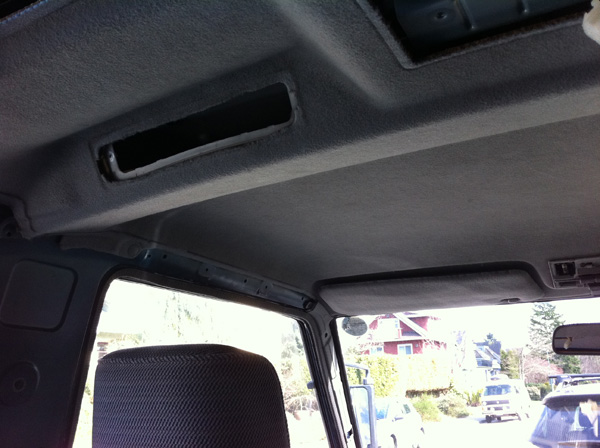

Does anyone know if drilling a hole in the area above the seat belt hardware (in the general area where the double headed arrow is) will cause any damage underneath? I picked up a cheap expandable curtain rod from Canadian Tire and thought if I drilled a hole on each side then the curtain rod would slide right in. This way, I could slide a privacy curtain across the front seats while sleeping in the back.

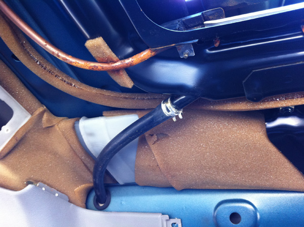

Hi, I just took my interior out (repairing the sunroof) and here's a couple photos I took of the area of interest:
I couldn't get the plastic trim off the driver's side, so I can't tell you what's there. But beware, in both pillars, the only thing I know is in there are the drain tubes for your sun roof. Those are pretty loose, so if you touch them with the tip of the drill, they'll probably just bounce out of the way.
That said, maybe take the point off the screws so you're not introducing something sharp for the drain hoses to rub against.
