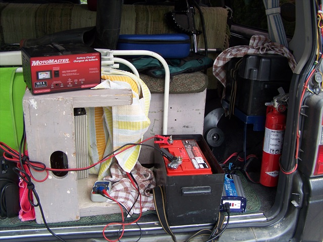

Electric trolling motors are great, dead batteries are not! For longer fishing trips I find I get 2-3 days from a battery if I'm conservative on the throttle and it's not windy (3 HP motor ). Last year I connected my trolling battery to the Delica charging system and in a 3 hour drive I did basically nothing to recharge my trolling battery. I monitored the current going in and it rarely got over 4 amps so it's no wonder. The voltage quickly rises on the trolling battery and any voltage drop in the wiring eliminates a faster charge. The solution is to run and inverter from the Delica supply and use a normal battery charger. This way I can get more than 10 amps for a while and 8 to 10 amps until the batteries charged. My new Odyssey takes less then 4 hours to completely charge and the old flooded battery takes a little longer.

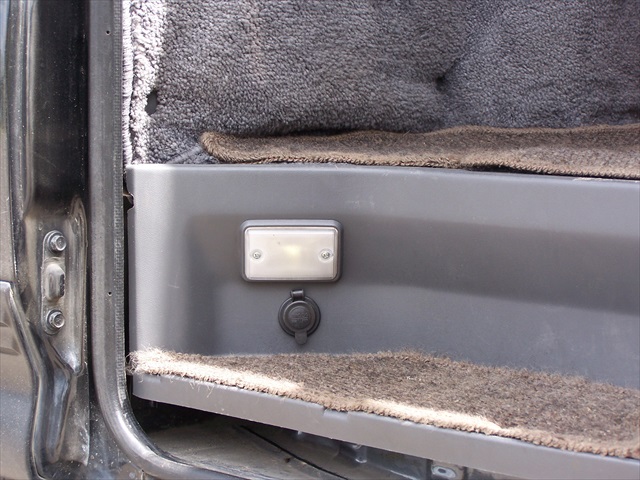

I have 2 outlets in the back and 1 @ the step ranging from 10amp to 30 amp capacity. Now voltage drop is no problem just don't charge the trolling battery without the van running!
Charge Test System
Charge Test System
20 A Outlet
20 A Outlet
