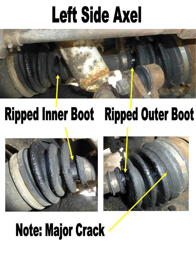

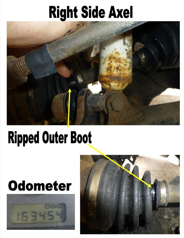

23/4/2013 Discovered 3 ripped cv boots (See attached photos)
(Odometer 163454)
Well under warranty. The dealer refused to refund my money or send new parts. Claimed that the boots could not live up to Canadian climate. He claimed, too much heat, and too much freezing caused the problem. (huh?) Offered to send new boots (same as the defective ones which already claimed would not last in Canada). I declined the offer.

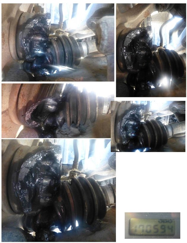

18/08/2013 Drive shaft destroyed (odometer 170594)(photo attached)
Note:Still well under warranty 1 year/20,00km
My mechanic said he has never seen this in all his years on any vehicle.
(Odometer 163454)

hi, that's sad,
do you have a higher lift in your delica.
if you do have that could always be the problem all the time
boot will damage every 2 or 3 month even new.
but actual drive shaft could be made in china not good quality one or just defective don't know.
have some good used one come from japan on my scrap delica if you need some

I have seen a CV joint grenade like that but it was a lifted IFS Nissan pickup. The joint couldn't handle the increased drive angle and it snapped off just like yours did. I am sure that his 33" tires also contributed to the misery. What a pain in the a$$, he only had 2wd and an open diff so had to be towed out most of the way
If Mardy has used shaft's with boots that are good condition and the joints are also good then get a set. Delica CV boots can also be purchased closer to your home from Toronto. I doubt he has cv axles.
