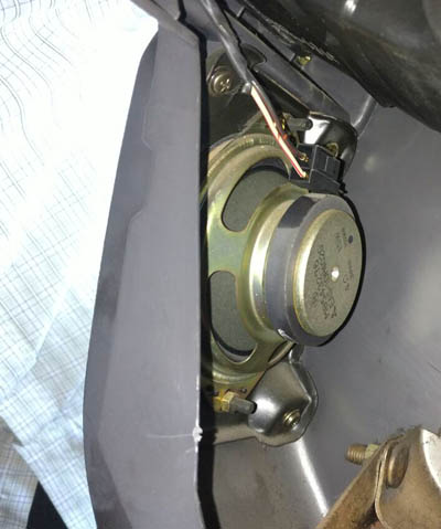

Ah.... Wait. Just unscrew these 4 screws?
https://www.dropbox.com/s/5sf1hixszckxw ... 9.jpg?dl=0

by Growlerbearnz
Yep, that's them. The speaker comes out attached to the mounting bracket. I have no idea why Mitsubishi chose to install both speakers so differently either. They're also weirdly sized speakers, installing anything different will involve drilling new mounting holes in the bracket.

by pluckmyeyeout
I got it. Holy moly is that STUPID. For future reference there are the 4 phillips head screws that removes the whole bracket. Depending on the speaker you have, you MAY want to retain the black plastic risers under the bolt and the cardboard circle in order to get a flush mount that makes all the clearances. What a terrible design. Additionally, I'd recommend something like this: http://www.amazon.com/DEWALT-DWARAFS-Ri ... B013UBXU3E. A shorty screwdriver will work, but it won't be easy.
