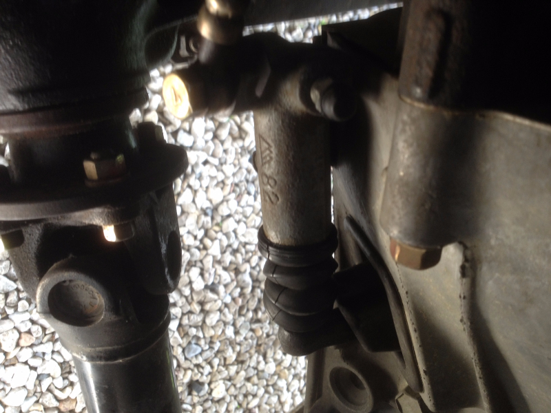

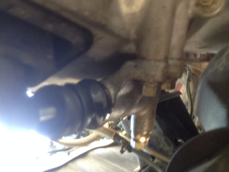

Here are some pics of the offending part.
