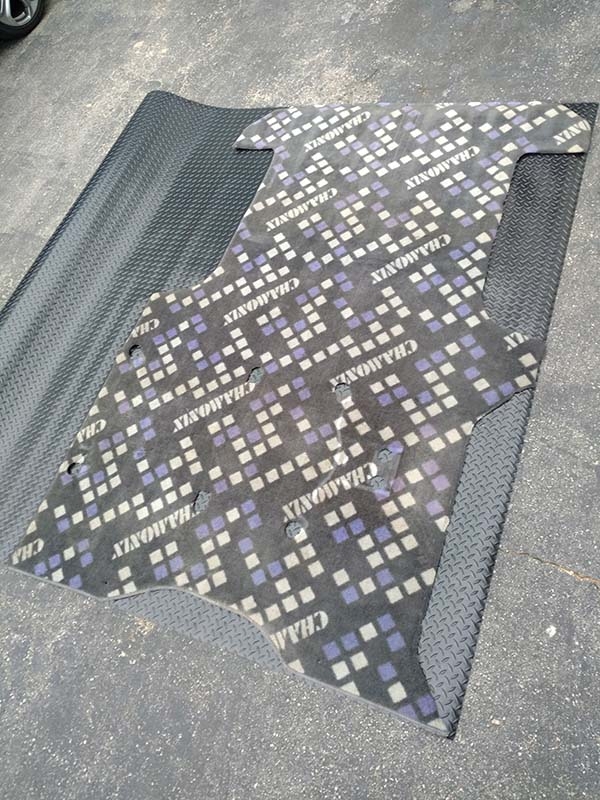

After doing some measuring, I thought that this was the only thing that was going to fit... I measured the original rug at 8' - so I thought I would have to trim the rubber flooring down the long way, but once I took it out and lined it up, it was the EXACT size of the rug on the SHORT (7.5') side. So either I measured wrong, or the flooring was 8'. Probably the former. I didn't actually get the tape measure out when I had it on the ground.

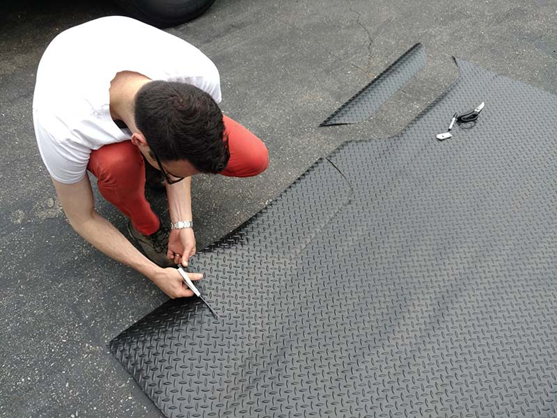

So I lined it up, drew out the pattern with a sharpie, and just cut away. I had some pretty standard (but newer) titanium scissors that worked well. Snips or shears might work better. I used a standard razor knife to cut out the circles.

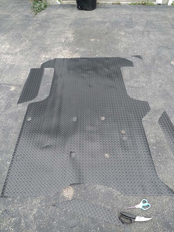

All done:

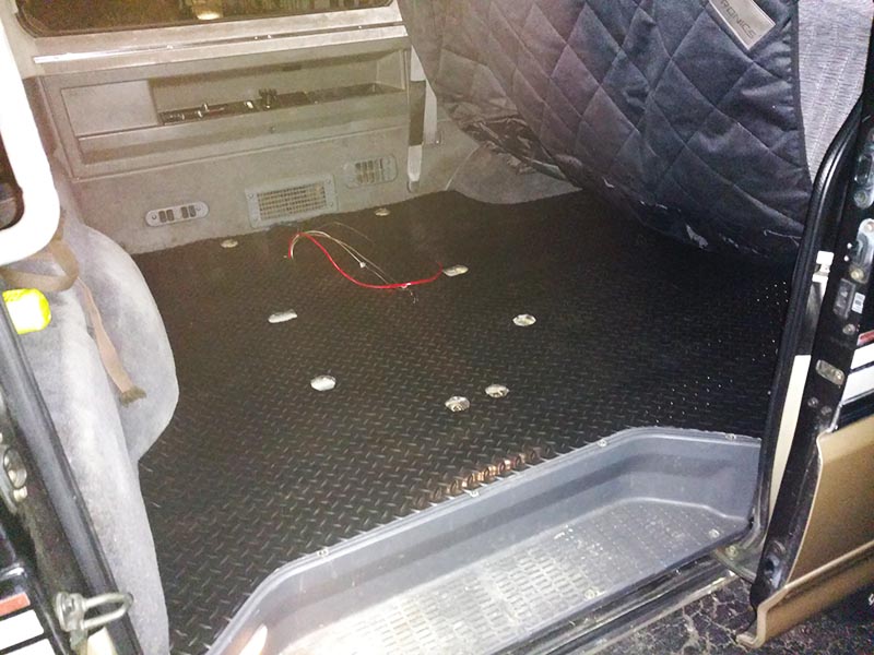

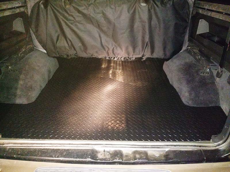

Installed:
I just reinstalled the carpet and laid this down on top. Fits great. Looks good.
I decided I wanted to keep it simple. I didn't screw it down under the rear/side trim. We'll see how time treats those edges.

So, if anyone chooses to follow step, I'd recommend a few things.
1) Let the rubber sit out flat for a day or two before cutting. I've got a few wrinkles that I think could have been resolved through just letting it settle for a bit.
2) Cut a little bit extra room around the bench seat attachment points. It's hard to see from the pictures, but there are a few of the bolt points that are sitting on the rubber and sort of pinching it a bit. I'd just make a note of where the bolt points are sitting on the rug and cut a little extra rubber away. Alternatively, you could probably get crafty and cut LESS away, so the rubber covers the feet entirely. The OG bendable metal covering with a big of rug is quite clever, but as long as you don't mind lifting the rubber away when you need to detach the seat, you could measure a bit better than I did.
Otherwise, I think it'll be quite good in the long run.
