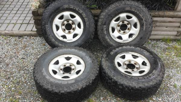

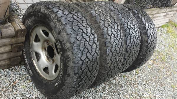

Looking at some beefier tires....
I have 235 75R15 right now
Can I safely install 265 70R15 tires on an L400 1994 2.8 SpaceGear??
What are the pros and cons??

You can install the ones you mentioned or these 2 which will fit a stock height L400 but it requires flattening of an inner fender panel near the door area.
30x9.50x15
31x10.50x15
