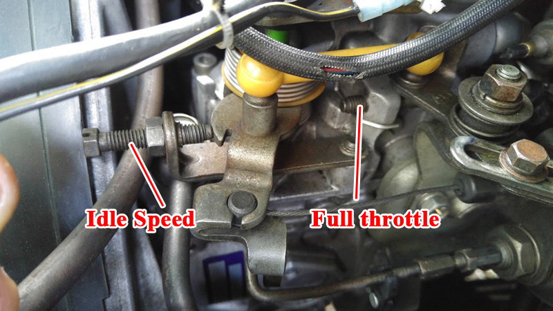

The fuel adjust screw *will* change your idle speed, but it should be a last resort. If something else is wrong (and I suspect it is) then using the fuel screw to correct it will only give you grief.
First up, adjust your idle speed screw so it's about halfway along it's range, like this:
Push the accelerator pedal all the way down, Check that the throttle lever hits the full throttle screw before the pedal hits the floor, and the throttle lever returns to the idle speed screw.
If it's still idling low, then I expect your throttle lever has been replaced a spline or two off.

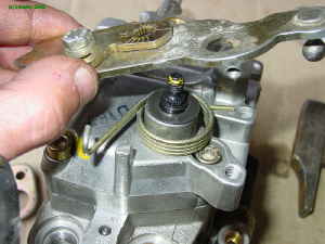

Remove the throttle lever, position sensor, and return springs (it's a shit of a job. Pay attention to how the return springs are installed and where they go.) The throttle shaft is connected inside the injection pump to a linkage with a bunch of springs. Turn the throttle shaft counter clockwise (as if accelerating) until you feel it take up all the slack in the linkage. Turn it one spline further, and replace the throttle lever in the idle position.
if you have to turn the throttle shaft back and forth to feel the slack in the linkage, try and avoid turning the throttle shaft clockwise too far. It's not usually a problem, but on some pumps the control linkage will fall apart if you turn the throttle shaft too far clockwise (decelerating direction).
(Lots of terrifying pictures of the linkage here: http://gnarlodious.com/Vanagon/Bosch_Pump/-Rebuild)
If your idle speed is still too low, and the idle speed screw won't adjust any further, try turning the throttle shaft one more spline counter-clockwise. if you have to advance the throttle lever more than 3 splines from the initial position (where all the slack in the mechanism is taken up) then it's time to fiddle with the fuel adjust screw.
