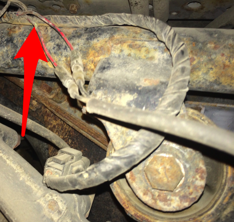

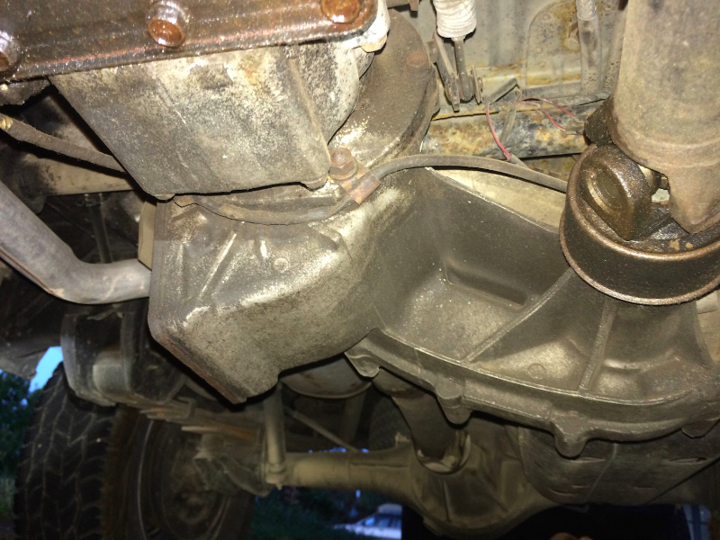

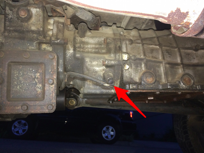

If my assumptions are correct, below is the wire as seen from the driver's side of the car: The wires swing back over to the passengers side: and this may be the culprit... a tiny discontinuity in one of the wires: Tomorrow I'll cut, strip, and re-connect... fingers crossed!

Nice pictures,
yes thats the switch and its cable, right. Glad you found it.
May I copy your pictures to help others?
Andy
Andy

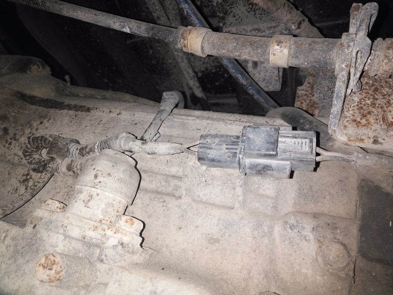

Is this the switch for an automatic ('92)? It seems to have a wire that goes to another sensor/switch on the other side. This is the left (passenger) side of the transmission.
- Reverse lamp switch?
- IMG_20160905_135308-2.jpg (437.82 KiB) Viewed 11483 times

Never mind it seems after digging some more I found out it is a solenoid. Anytime have a pic of it on an automatic or am I just blind?
