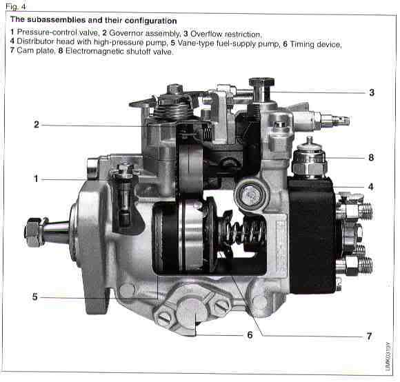

With the key turned on, check that there's power at the cutoff solenoid (item 8 in the lovely picture).
Did you check the oil level while filling with diesel, or poke at the engine while chatting about how awesome it is? Cutoff solenoid power comes through the two connectors on top of the injection pump, and they're kind of close to the oil dipstick- one of them might have come loose?

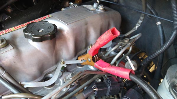

On another note, I just noticed as I was jiggling wires and trying to visually inspect circuitry that this little double-tabbed stretch of insulated wire is getting really quite warm when I turn the key. When I removed it and turned the key the glow plug relay clicked the first time, but didn't click a second time and it won't turn over when I turn the key all the way. See pictures of the wire attached and detached. Relevant?

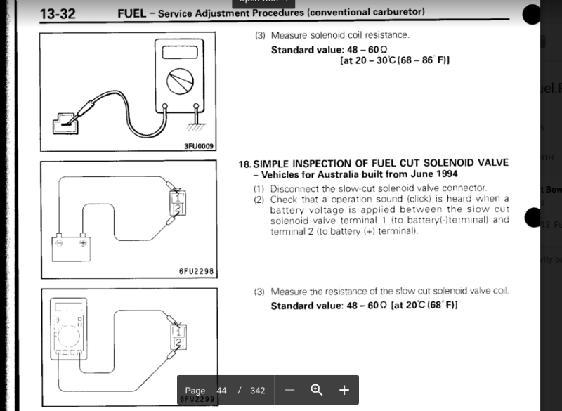

Came across below yesterday regarding fuel cutoff solenoid as I was browsing through. From 13 - Fuel. page 44. Not specific to your model but might be similar. Info on your model should be in there somewhere.

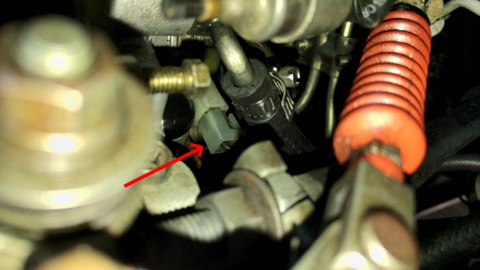

The solenoid is a pain to get to, but it has a connector on the back of the Injection Pump here:
It's easier to get to that one than to remove the rubber boot/nipple on top of the solenoid. Some solenoids have a screw connector under the rubber boot, some just have the wire. Unplug the connector and test the voltage on it.
You'd have to test the wire with a multimeter or a test lamp (a 12V bulb with wires. Much cheaper than a multimeter). You'd connect one side of your multimeter/lamp to the plug you've just unplugged, and the other side to something metal that's earthed- battery negative or the engine block is usual. Turn the key on and the meter should show 12V on the wire.
The piece of wire you've photographed is the fusible link that runs the glow plugs and the starter relay- it's not *really* a fuse, but it will be the first thing to burn out if something goes wrong. Interesting that it's getting warm- I've never tested mine, but there's a lot of power going through it so I wouldn't be surprised if it did get warm. The behaviour you describe with that piece removed (glow relay clicks but starter wont turn) is correct.
If the engine was stone cold when it failed to start I might suspect something was up with the glow plugs, but you'd just driven it and it should have been warm enough to run just fine.

Finally had a chance to get under the... well... not hood... seat... And it's reading 12.38V on the multimeter at the fuel solenoid connector. So that seems right, right? Did peek at the timing belt, and it looks like it's in place. Any other guesses? Next order of business before I just start wholesale replacing parts?

If there's voltage there it's a good sign. One last thing to check on the cutoff solenoid is to press the end of a long screwdriver against a metal part of the solenoid (or the injector pump body, as close to the solenoid as you can), press the handle of the screwdriver against your ear (it's a redneck stethoscope), and get someone to turn the ignition on and off (without cranking!). You should hear the solenoid click quite loudly. If it clicks it's probably good so;
