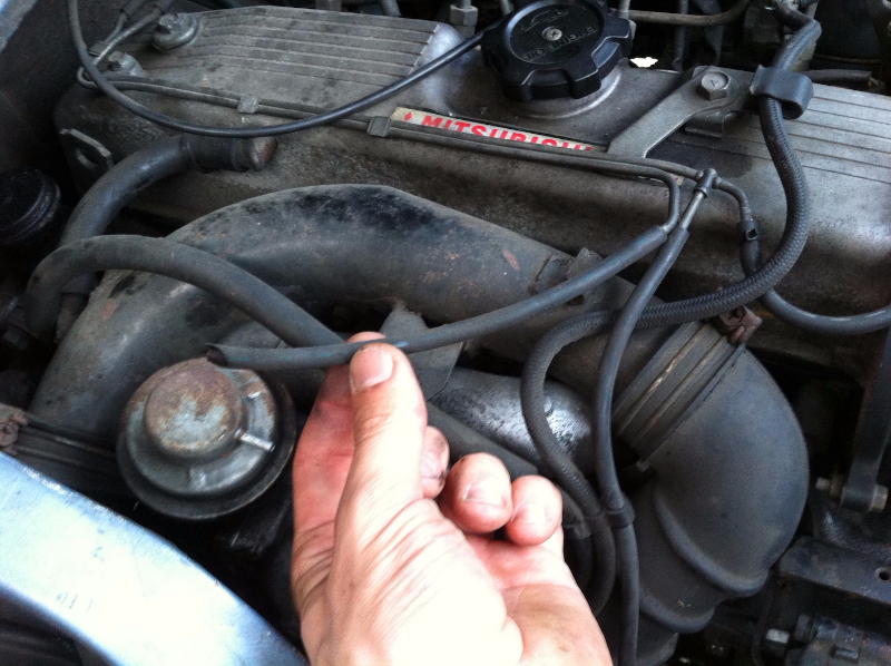

While beginning the alternator removal job I saw that the small air hose connecting to the waste gate has been disconnected. For who knows how long???

I'm going to replace it with a new one but can anyone chime in as to what having this disconnected does power wise?.

Luckily, that's the hose that goes to the Exhaust Gas Recirculation valve, which is the obvious canister in your picture. Having that hose disconnected means you'd have a vacuum leak whenever the engine tries to open the EGR, but vacuum leaks aren't hugely problematic on a diesel.
The wastegate actuator is further back and lower on the engine, at the end of the thick rubber-covered hose that's behind your thumbnail.

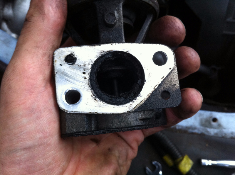

Well I gone and done it, cleaned the EGR and had a blast doing it. I know a lot of people blank this thing out but I'm a resto guy and I wanna see this thing in action. Removal was quite smooth thanks to Growler's helpful link from another site. Heres a first view after just removing it. Notice the 1/8" of soot coating the walls. The spring action was quite stiff as well.

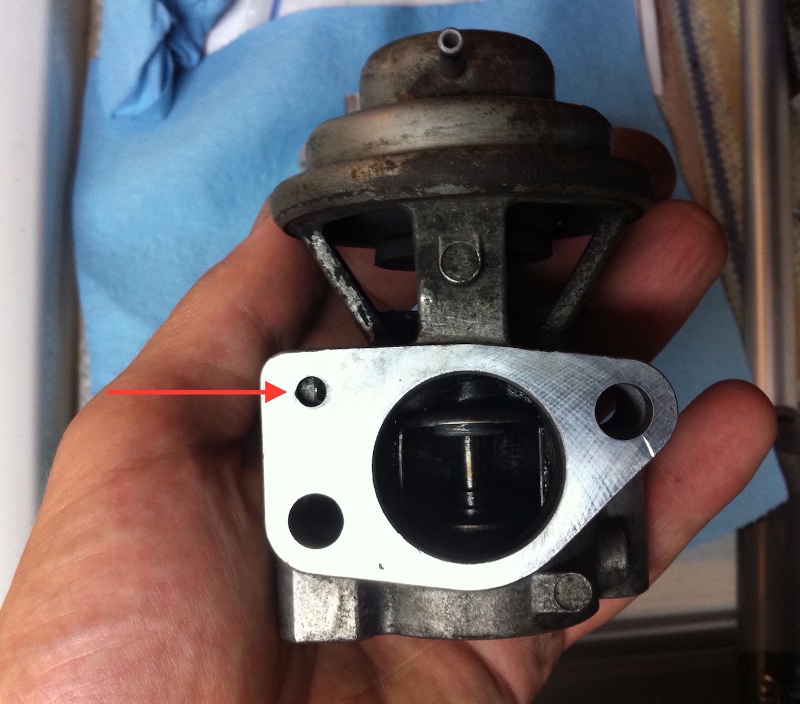

Here it is after some carb cleaner and scrubbing! Notice the little port the arrow is pointing to. It was completely clogged with grease and black death.
photo 2.JPG (520.36 KiB) Viewed 5316 times
The internal spring also freed up nicely so hopefully I'll report back with less smoke results after a longer test drive.
