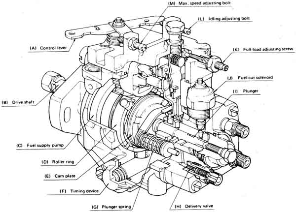

If the advance plunger is sticking you *might* free it up with some kind of additive, but I wouldn't expect the fix to last. The advance plunger lives at the bottom of the injection pump, so any cruft tends to collect there. The advance plunger cover plate is also a source of fuel leaks, and I've seen one or two that have been sealed with silicone (rather than just replacing the O-ring). The silicone gets into the plunger mechanism and you have to rebuild the injection pump. Look for leaks or sealant on the cover marked "timing device" in this picture:
