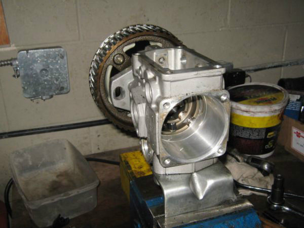

so with a little further investigating it appears that the pump is leaking from top gasket on engine side. Should I just have whole pump rebuilt?
- pump.JPG (44.38 KiB) Viewed 13894 times
- Growlerbearnz
- Posts: 2041
- Vehicle: Delica P25W
- Location: New Zealand
leaking fuel pump
If you've pulled it apart that far you might as well buy a rebuild kit (http://www.ebay.com/itm/GASKET-KIT-REBU ... Gs&vxp=mtr) and replace the seals yourself. I'm guessing you've seen the Gnarlodious VE pump rebuild how-to? http://gnarlodious.com/vanagon/bosch_pump/-Rebuild
