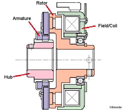

The front plate with the 3 screws (Armature) is the bit that drives the AC compressor. Behind it is the pulley with magnetic coil (Rotor and field coil). The rotor should be spinning all the time, the armature stationary. Turn on the AC and the coil pulls the armature into contact with the rotor, they lock together and you have AC.
So the armature was spinning even with the AC turned off? That's not right. I'd give it a good clean, there may be gunk built up in the tiny gap between them, especially if it's not been used much.
If the armature was spinning slower than the rotor when AC is turned on it could be a weak coil, dirt in the gap, or a failing, almost seized AC compressor. Or a failing bearing in the AC compressor...
I'd remove the AC compressor and check it out before ordering a new clutch. It's possible your clutch is fine, and it's the compressor that's failing.
