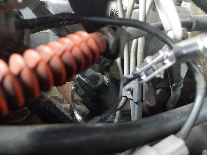

Where's that full load adjusting screw? Anyone got a picture/diagram?

So this is above the fuel cutoff solenoid... Is it a cover to the screw or is it the screw itself?

That's the screw, but it still has its anti-tamper cover on, which suggests it's not been messed with. (The screw without cover is shown in step 10 of this post:http://www.delica.ca/forum/viewtopic.ph ... 5&p=139658)
