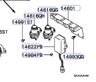

I recall the setup for the solenoids, but which one os 6 and which is 12?
Screen Shot 2018-01-03 at 1.56.47 PM.png (49.84 KiB) Viewed 12235 times
Thanks as well for the jumper tip, but before I electrocute myself am I basically taking jumper cables, grounding both negatives, then one positive lead on the battery and one on the bus bar (for 7 secs)? Also does it matter which battery I connect to if I'm running the dual battery setup?
Thanks,
Eric
Another hard to start in cold temperature question.
Posted: Wed Jan 03, 2018 3:32 pm
by Growlerbearnz
I would test them like in the youtube clip- resistance is nice, but seeing them glow is better. I would heat them, counting the seconds, until they glow a bright orange. I would expect it to take 4-7 seconds, but as long as they all glow in about the same time they're fine.
Don't drop them or treat them roughly. Wear safety glasses, just in case one shatters. It shouldn't, but you never know.
14616QG is the 12V solenoid. This thread: http://www.delica.ca/forum/viewtopic.ph ... id#p133525 shows the glow plug solenoids, but TL:DR; to apply 12V to your plugs for fast warmup you want your manual button connected to the solenoid with the spade terminal, not the solenoid with the phillips screw. (That's the 6V solenoid, which is used to keep the plugs warm once the engine starts).

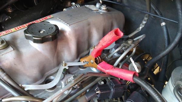

For the jumper test, you only need the red cable. One end to positive of one of your batteries, the other end to the bus bar like so:
Be very careful not to touch the alligator clip to anything other than the bus bar. If you touch the head you'll get some very exciting sparks, if you touch an injection pipe it's ruined. Maybe put insulating tape on the outside of the clamp's jaws, and tuck a sturdy rag under the bus bar (covering all the earthed metal around the area).

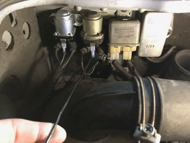

Okay, so didn't get to much tonight but I can show you guys a few things.
It appears my mechanic wired the button correctly, as the wire is running to the 6V solenoid. The negative wire runs to the fusebox at the firewall near the steering column. I didn't dig much further there.

The way you are currently set up you should hold the button for about 6 seconds (applying 12v) and then attempt the start. After/during start you may need to push the button *momentarily* to keep things going smoothly... this is where the system would normally switch over to a more sustained 6v glow cycle, but you can't do that.
The problem with manually applying 12v to 6v plugs is that it's easy to burn them out and you have no way of monitoring them. If you are running a manual switch only, I would probably switch to 12v glow plugs. You can still burn them out, but it's a lot less likely.
