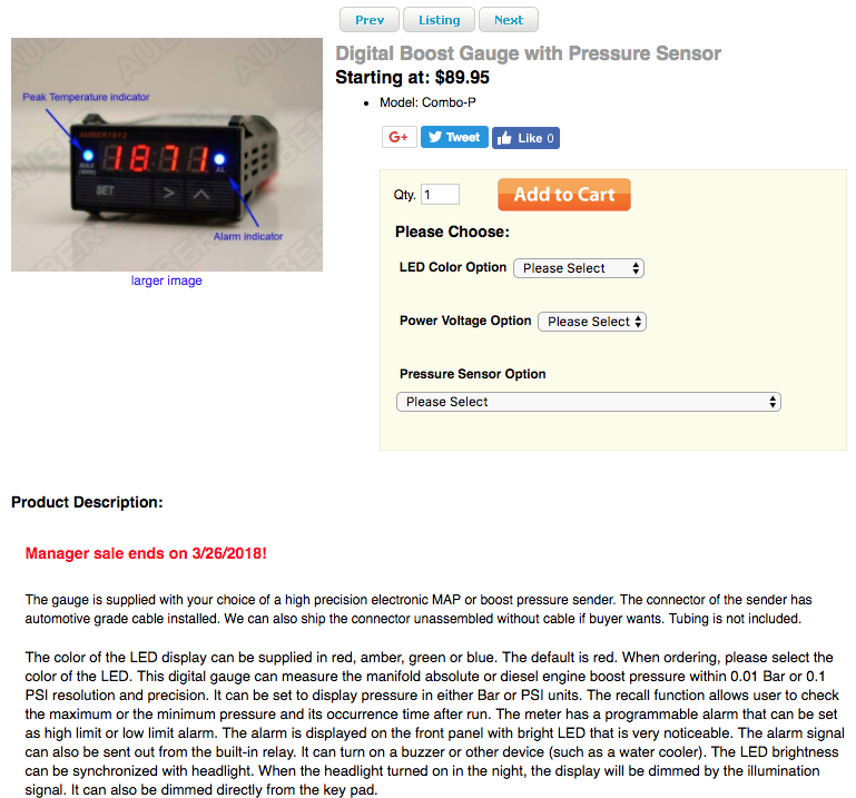

I have purchased an Auber digital boost gauge that I intend to install alongside my Auber EGT gauge:
Screen Shot 2018-03-27 at 1.46.36 PM.png (211.2 KiB) Viewed 6193 times

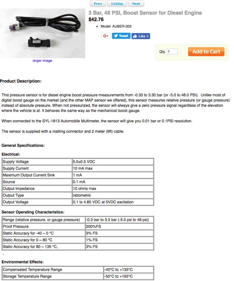

Sensor:
Screen Shot 2018-03-27 at 1.58.38 PM.png (310.59 KiB) Viewed 6193 times

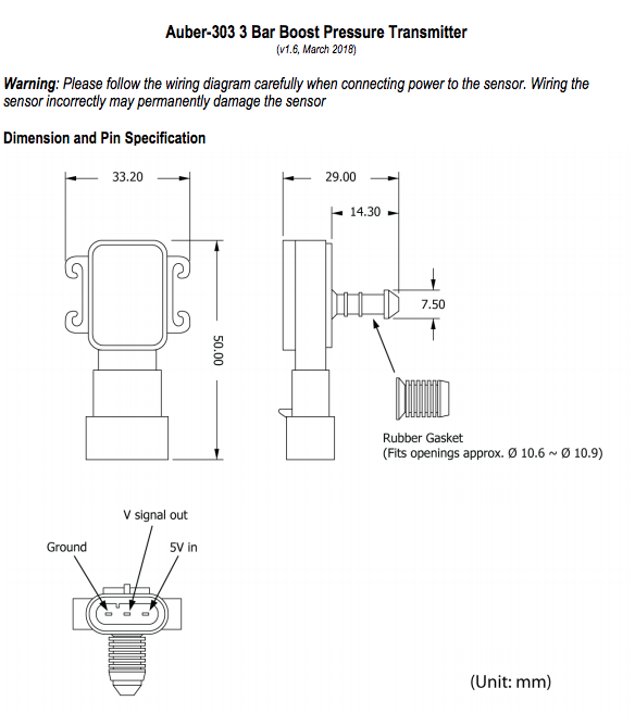

I'll add a t-connector then use another small piece of hose to run to the Auber sensor shown below:
Screen Shot 2018-03-27 at 1.39.47 PM.png (85.58 KiB) Viewed 6193 times
Wiring the sensor itself will be pretty straightforward, it's just splicing and running the tubing that I want to make sure I get right the first time.
Weirdly it says the sensor only takes 5A? Is it that the digital gauge itself reduces the voltage (it is a 12V DC gauge)

I assume you mean 5V and not 5A. Automotive sensors commonly use 5 Volts. The gauge reduces the supply voltage to the sensor to 5 Volts.

Hi 204Explorer, thanks for the insight, I looked again and yes it says 5V, so no worries there!
