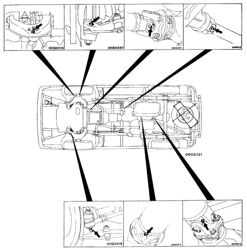

I had a similar sound a few weeks ago. Got out my trust grease gun and hit all the nipples (especially the ones on the front suspension). No more squeak!
*** NOTE: just do ONE squeeze of the grease gun per nipple or you can blow out the rubber covers!!! ***
It takes a bit of sleuthing to find some of them, all caked in road grime, but a good wire brush cleans them up pretty well.

deskinthewoods wrote: Fri Mar 15, 2019 11:35 am I had a similar sound a few weeks ago. Got out my trust grease gun and hit all the nipples (especially the ones on the front suspension). No more squeak!
Dang, of course! :) Thanks! Poor BJ's don't have nipples. :(
