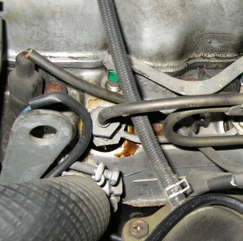

I don't understand that much about cars (but I love already my Delica) either I don't know how all this part called in English, but can anyone tell me if this fresh leak of oil will cause any problems soon. Should I let it repair in a garage?

Hi, check first if this is oil, or other thing,
seem to me in the picture not oil color is brown, so dont know if an old anti freezed or other thing.

I am more inclined to think the seal at the base of the injector (Injector to engine) is leaking, allowing a bit of blowby. Either way, might as well go visit Mardy and get it all cleaned up and resealed inside and out.

I checked it again and it seems to me it is oil coming out of this injector.
I was thinking about to get the CVI tune in a couple thousand km, cos I need to change the oil & fluids anyway. So doing everything (oil change, tune and fixing this problem) together would be my plan. Do you think it is all right to wait this distance?
