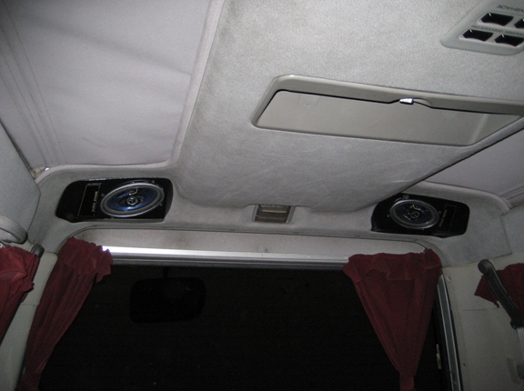

After 4 months away from home working and surfing, I finally have the time to start doing the mods I've wanted to do since first buying My MitSurfbishi.
Can cross a few off the list after the last few days.

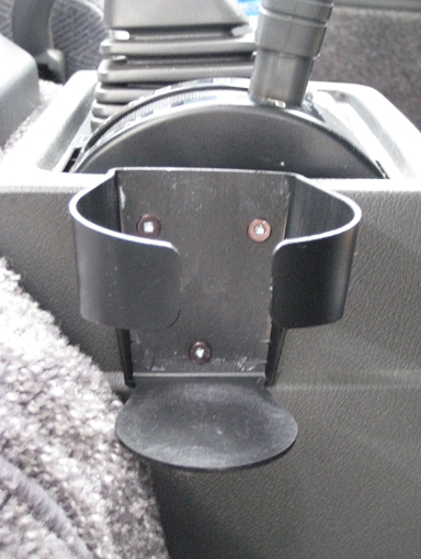

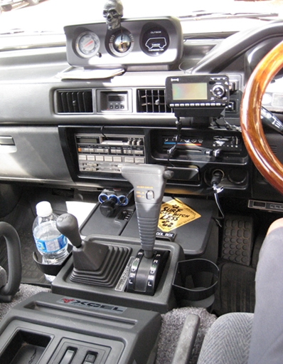

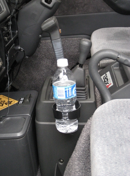

-Custom cup holders. Super easy Cambodian Tire window hung style, chopped flush-ish to top of shifter console, holes counter sunk, then screwed to each side. There's just enough room there for the seat to flip up without hitting them as well as knee clearance. -Next I installed my XM radio and upgraded some speakers. 4" Alpines in the front dash......yup had to do the mirror/flashlight contortion maneuver on that damn ridiculous passenger one. WHY THE HELL didn't MMC just mount that one like the driver side!? Much horrible cursing ensued for sure!

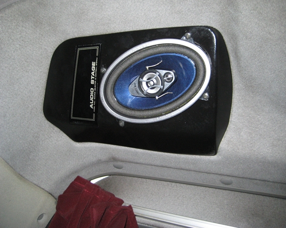

- Then the Sound Stage bunk 4 inchers in the back had to go. I found some 4x6's on the clearance table @ Visions for $40. I decided after some deliberation to pull the old cloth off the Sound Stage covers, cut oval holes in them, sand off the old glue, spray them gloss black, pilot the screw holes, and mount them on the face of the covers. If you have ever pulled these covers off you know there are spring like clips that click into holes in a steel bracket. I managed to cut my ovals just so that one of the clips was salvaged and was able to anchor the unscrewed side down.
If you want bigger speakers in this spot you will have to grind away some of the steel bracket that used to hold the stock ones. I had to grind out a section to give enough clearance for the magnet and connector tabs(Sorry didn't have my camera with me when it was all apart).
- The other rear speakers can wait til I decide on a new deck to go with my amp and sub box. I may be pulling out the rear slave unit(that works) and mounting my amp in that slot...we'll see.
Til next update.....
Sean

dude, that speaker mod is really nice!
Re: Rear speaker and EZ cup holder mods.
Nice set up, MitSurfbishi...
~ the cup holders, too.
I really like the rear speaker upgrade. Been wanting to do something to mine because I can hear the paper cones have all deteriorated (lots of 'rasping'). Nice idea!

sweet cup holders - you know i bet the bottle holders I use on my mountain bike would work there. thanks for the idea.
