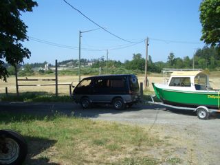

Re: Comox questions
16ft 50hp about 1500lbs
not too fast up hills but managable.
