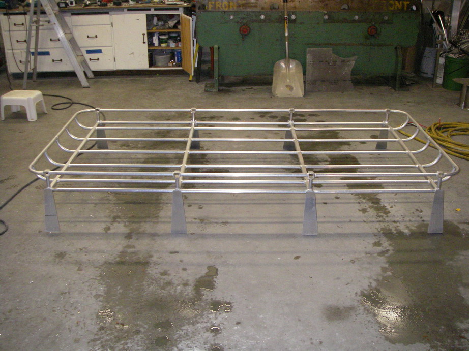

I now have a super rack that kicks ass!!!!
Have I got the Rack NOW! It is a massive basket rack.
A guy in Victoria built it and it rocks!!! I will post photos later. I have a low roof and it is built to be underheight on Ferry. It is able to take a 4X 8 sheet of plywood and we've had FOUR people standing on it!!!! It has four connection points and two people can easily take it on and off. Beautifull work too.
The guy's name is Kevin and his company is called Burning rod Metal works. He has one High roof rack built already.

That is a nice rack, how much?
Can we have the contact info for Kevin?
