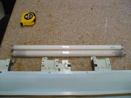

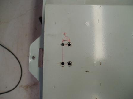

I think that's a hard find, I asked at the shop where I bought Duke and they didn't have any. I was told its only avalable in Japan. I didn't try Japaniod or any of the other dealers, but I did take the tube out and managed to replace with an off the shelf 24" tube from Rona. The factory tube is 24 5/16" long, so I had to take the assembly out of the van and move the tube connector 5/16". Now anytime the tube buggers up, I can replace with a $7 light.
- Duke 006.JPG (20.28 KiB) Viewed 3419 times
- Top tube Rona, Botton tube Delica
- Duke 004.JPG (38.49 KiB) Viewed 3419 times

In the second pic...are you sure that the TOP is Rona and the BOTTOM is Delica? My tube is quite a bit smaller in diameter than the hardware store...it looks opposite in yours. ALSO, my lamp is only 22 and 7/8" long apposed to the 24" from the hardware store. You said yours was 24 5/16?? Hmmm, maybe different models have different tubes. I'm driving a 1993 OFFROADEXPRESS Super Exceed.

The bottom tube is burnt on the ends, you can see that. The top tube is smaller in diameter and shorter in lenght. My van is a 92 Super Exceed, but either way all you should have to do is remove two pop rivets, move the connector to the lenght of the new tube and pop rivet back in place. The new light is nice and secure and nice and bright.
