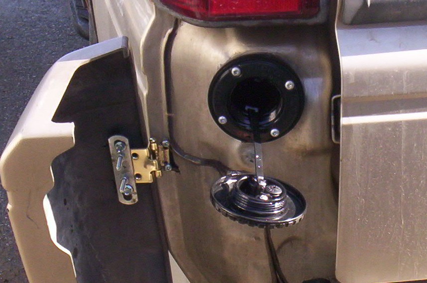

Have you considered a WVO Exterior filling point for your Delica? The body panel rear walls lend themselves well to this.
These are the filling points I installed on mine (always thought a swing out rear light assembly, with WVO filling inside, would be a nifty project);

Looks nice. I did a filler like the first one through the wall of my 1.9 Vanagon conversion a few years ago.
We'll take another look at that.
So far, the big "spill plate" (complete with lip out and down, at the rear, out over the rear trim, with flush filler cap, and gauge-at-rear, appears simplest for the DIY installer (and least time consuming for when people are coming and staying here a couple of days and want to keep the price down, and get back home).
I also like to put in a big rubber mat from local outfit Dinoflex, in the rear of the vans, too.
They make these really skookum, flat big mats, from recycled tires. Tough, and cheap, too! Every van owner should have a few, one for the rear, one for the outside....maybe custom cut ones for front floor mats (although I have to say I have not tried cutting them - it might be quite a chore).
Anyway, there is no reason a person can't connect a different hose - we just have a threaded stub on the tank, and then we add a length of pipe, then rubber marine grade filler hose, a short piece, and then, from the top, push the flush-filler down into that - a very snug fit - but it does not have to be done that way, just add your own filler of your own design if you prefer.

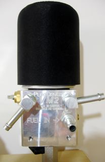

Curious, installing the VM2 against the tank? Does it make the path for the oil going to the engine a little long and cooling down or does it work fine as you would have a Vegtherm...

The oil is heated by the in-tank, coolant operated heater, then again in the coolant-heated filter (which in future incarnations, will be the VM2... or the TurboFyner, your choice, and will be a top-mount filter (element at top) with the element also having our new filter "Took"; a neoprene filter element cover that insulates the element (and looks pretty cool, too!)
Then we heat-trace the vegoil supply line with the coolant lines running to and from the rear heater, then the vegoil supply line follows the original steel hardlines (coolant) across and up to the engine bay....then it's heated again by the Vegtherm....then it returns to a looped return....it all adds up to oil that is heated progressively and is nice and hot where it matters.
