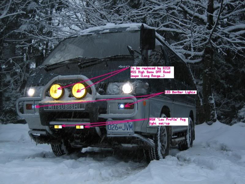

Hi everybody,
Although its been super foggy in the Vancouver area for days now, I have this plan in the back of my head to actually replace the fog-lights that are mounted on the front bumper assembly with some "kick ass heavy duty super bright off-road long distance high beam searchlights..." (something like a million candlepower kinda-thing)....
As an alternative I would then mount low profile (i.e as flat as possible) fog lights just onto the lower bar of the front bumper... (the bar that goes across in front of the radiator air intake... there are actually mounts welded on the backside of the bar... I copied "imaginary" lights onto the jpg posted below)
Here are my questions:
Has anybody done such a change on their Van? ... and if yes....
Are there some good long range lamps that you recommend / or a place where to get them? Some place with maybe a bit more selection than Canadian Tire?
Is there a maximum wattage that I have to consider for such lights (normal headlights and highbeams are around 50 - 60 Watts - but some aftermarket bulbs claim to have 80 / 100 Watts...)
Would I run the risk of frying something up if I were to go 100 Watt for the auxiliary lights? Especially since they are controlled by a separate switch.
PS: Does somebody know if it would be "legal" to run the position/marker lights as DRL-lights?
I put LED bulbs into my marker lights - they are WAAAYYY brighter than the original 5 Watts and have only a fraction of the draw on the batteries....
Thanks for any feedback or suggestions,
Cheers, Chris

impalator wrote:to actually replace the fog-lights that are mounted on the front bumper assembly with some "kick ass heavy duty super bright off-road long distance high beam searchlights..." (something like a million candlepower kinda-thing)....
http://www.delica.ca/forum/100-hid-euro ... -4341.html
They consume 33 watts at their peak and put out 4-5 times the candle light output that a 100W spotlight does.
impalator wrote:Is there a maximum wattage that I have to consider for such lights (normal headlights and highbeams are around 50 - 60 Watts - but some aftermarket bulbs claim to have 80 / 100 Watts...)
Yes. 55W is that max I would run bulbs/lights on the stock Delica wiring. That includes replacement fog lights.
If you do run a higher wattage, than make it it's own circuit (separate wiring/switch from the main Delica wiring harness)
impalator wrote:PS: Does somebody know if it would be "legal" to run the position/marker lights as DRL-lights?
I put LED bulbs into my marker lights - they are WAAAYYY brighter than the original 5 Watts and have only a fraction of the draw on the batteries....]
Not legal to use the marker lights as day time running lights.
