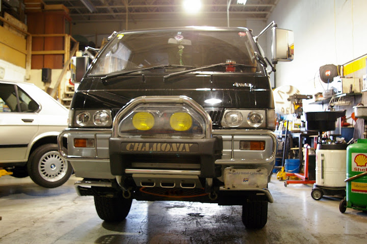

Today we visit CVI for a little on board tuning.
This is the Miss Lil' Bitchi.

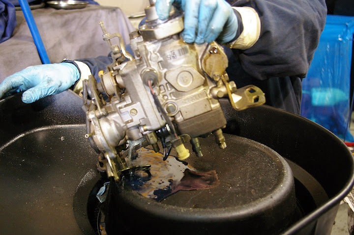

This is about half a litre of diesel going down the drain. Once the diesel is drained out of the pump the next step is to clean all the residue off ~ cleanliness is next to Godliness.

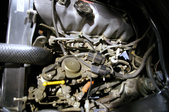

This is the rest of the engine. Hmm, looks a little dirty ~ time to do a little cleaning. This is something I like to do. Apart from the engine performing better when it is clean, I also get a kick out of watching the faces of people looking at my engine, I am told that this is strange behaviour :twisted:.

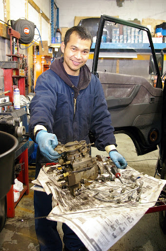

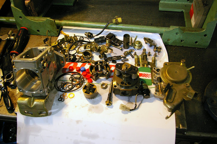

This is what the I.P. looks like in pieces. I am led to believe that Edwin does this sort of thing instead of jigsaw puzzles or crosswords. The new seals are in this picture.

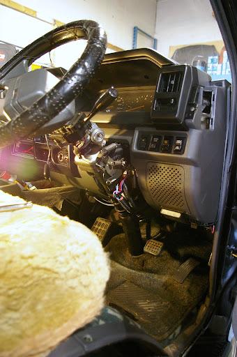

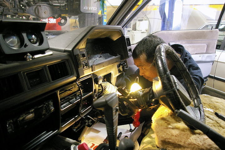

While Edwin is working on the the IP, I am taking things apart on the other side of the van so we can get to the master cylinder. I have a leak and there is brake fluid all over my mat.
Edwin took the master cylinder out and replaced it with a new one. This procedure went quickly.

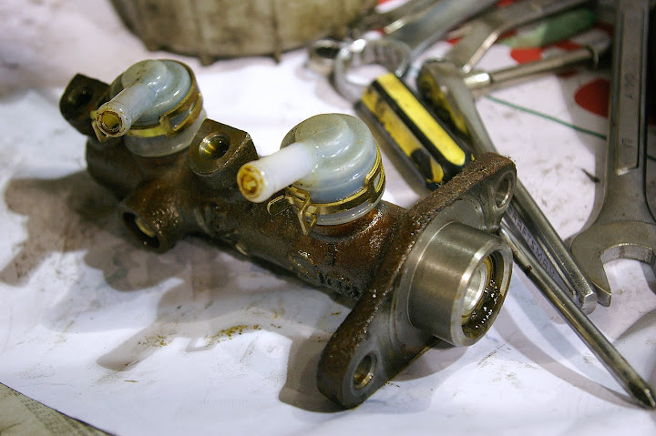

This is what the old one looked like...
