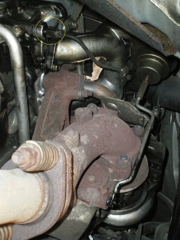

I was doing an oil change this afternoon for a long road trip we have on Tuesday morning when I noticed these two leaks.
First one is up near the intake/exhaust manifold. There's a small tube and nut where there was a drip - I've circled the area in yellow (hope you can see it). The picture was taken from underneith and I tried to include the turbo for point of reference. Basically this shot is lying on your back under the driver side tire looking up. The yellow is where there was a drip, but it could possibly be coming from something else in that general area. I also have the typical turbo drip for the past year.

Looks like either your valve cover gasket leaking onto your oil feed line, common, no big deal. Or it could be your oil feed line isn't tight enough, has anyone pulled the turbo off your van recently? Check with a wrench, but don't go crazy on it just make sure it's tight. Again, not a big deal unless it is leaking copious amounts. For your rear diff, that would be your pinion seal, you should replace that, unless of course you like the rust protection that the gear oil provides, lol.

THanks Mephis for the quick response - I'll try tightening that nut a bit, and try to see if it's a valve cover gasket leak.
