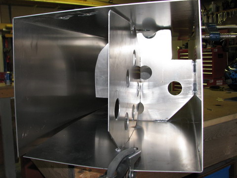

Here are the inside baffles of the belly tanks.

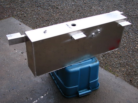

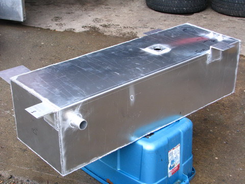

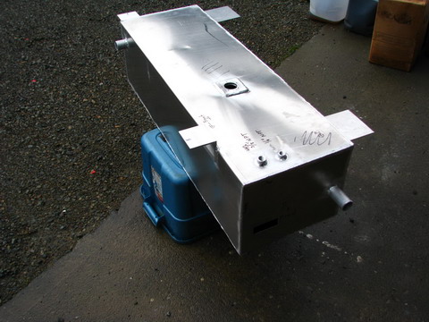

Will use a siphon system like in my L300 :M . Fill WVO will come from the stock fill cap. There is a rear transfer hose way above axle. Notice the square cut-out where the heater and pick up will go. This is the first of the two tanks with one almost finished. The muffler will be coming out just behind the driver's door :? to fit right tank. Taking out the mild steel tank and replacing with an aluminium one on the left side.

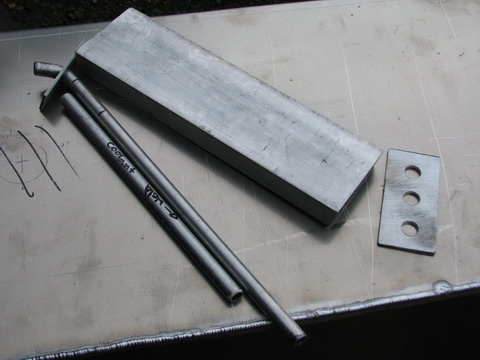

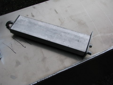

invented an in tank heated fuel pick-up that should be interesting to see how it will work 8-) . It is using a 8cmX4 cm aluminium square tube with a 3/8" aluminium tube running through it.
Here are two photos of the Diesel tank that will go in front of the spare tire. It will fill from a new port on driver's side, behind panel below signal light.
Fun little project to see if I can run a better balanced tank system and have my spare still in place.
