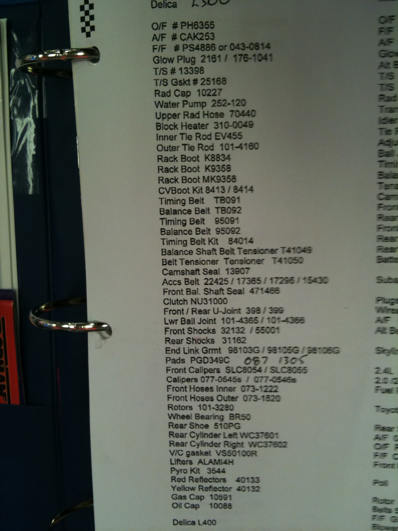

Yer gonna laugh, but here is an iphone snapshot of the L300 list from Lordco's internal cheat sheet.
Note the rotors 101-3280
Richard Dagenais

That parts list is awesome!!! Thanks for that.

That is sweet !! no more trying to figure out what the heck to ask for !
I am going to use that info right now..
rad cap
rotors
pads
and shocks !!
This needs to become a sticky !!
