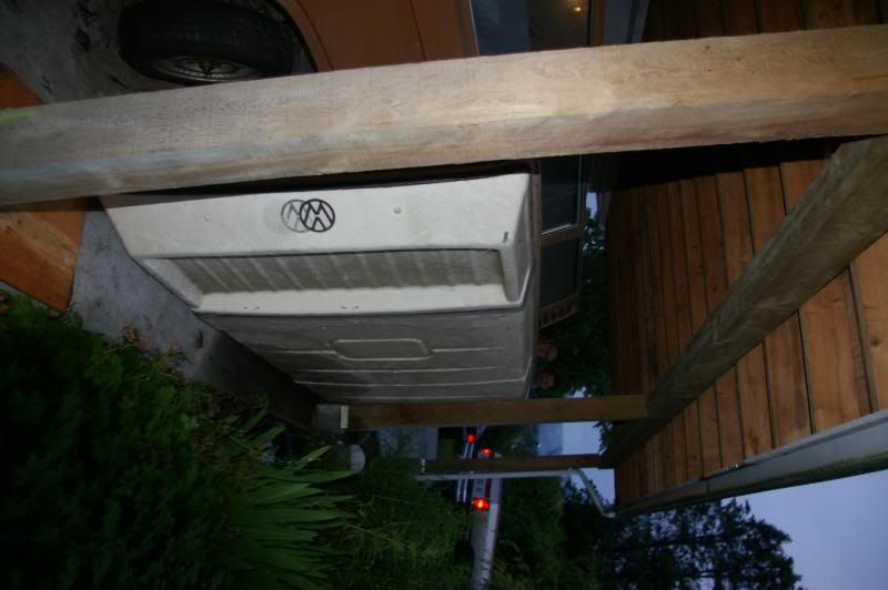

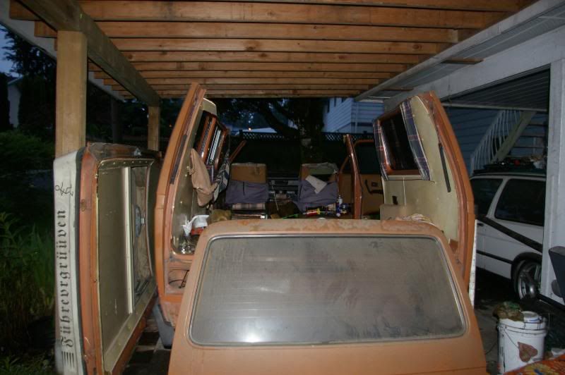

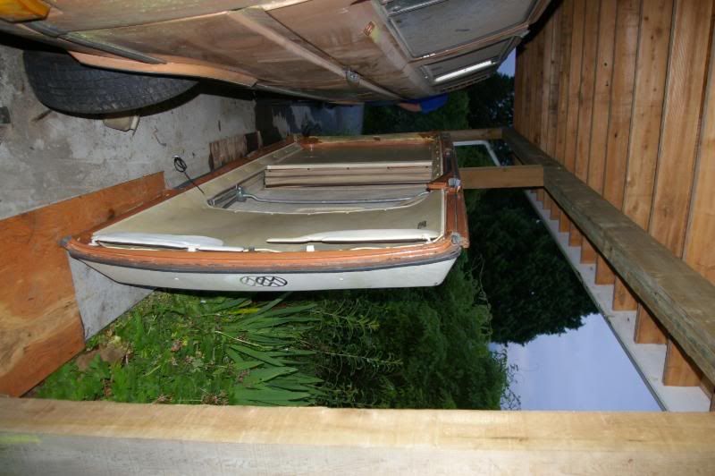

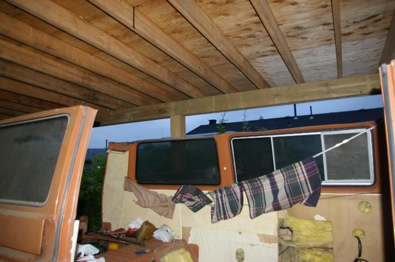

Thought I would start a new thread....So I cut the roof of a 1981 VW Campervan last week and finally picked it up tonight! Now the real fun starts!!
Here are the first set of photos.

Progress so far (sorry forgot my camera)
Roof:
Got the old roof (VW Westy) unmounted. canvas off.
Looks like I will need to take out 5.5 inches out of the middle of the long roof and 16.5 inches out of the front cargo holder end.
Challenges: Delica roof is flat with ribs long way (problem for water pooling over the VW roof which is arched and has ribs sideways).
May glass the front ramp up piece onto the larger roof so it is a one piece roof to make sealing easier? Still work through it in my mind.
Next step is to cut the large roof to fit and then deal mount it to the roof (no hole cutting yet till I commit and see how it looks. Probably tack the hinge to the roof to see???
