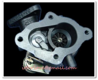

http://cgi.ebay.ca/new-Mitsubishi-TF035 ... 2a090774f9jfarsang wrote:A full rebuild is between $5-600 and a simple clean is around $200
Is this a good deal? bad deal? correct part? silly lopar?
Would come in around $350 'ish.
