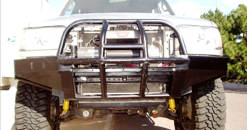

Well, I wish I could help. The only useful thread on delicaclub.ru is a 17-page discussion regarding front 'winch' bumpers for an L400. Below are some pictures to inspire you.
A few forum members have brought up a safety concern; a strong steel front bumper is a deadly weapon in a collision as it does not absorb the excessive force.

Make sure you get the same weight of your front bumper somewhere in the rear (maybe rear bumper?). The l300 is already a lot heavier in the front than in the back. You don't want to add on another few hundred kg to make it worse.

Profister wrote:A few forum members have brought up a safety concern; a strong steel front bumper is a deadly weapon in a collision as it does not absorb the excessive force.
Very true, also depending on the vehicle it makes pedestrian collisions much more deadly. The problem with bush bars and ARB style bumpers is they're really made with only one thing in mind, off road capability. However, if you've ever driven a stock truck offroad and nudged a tree you'll see just how "crumply" your bumpers soft spots can be! It's a bit of a toss up and I guess it's up to the person who owns the vehicle. If you're offroad enough and you're driving on some nasty roads then you may need that big bumper. But if it's just for show then you're doing something dangerous for really no reason at all.
Another thing about the big heavy bumpers (and skid plates) is depending on how the crumple zones in your vehicle are laid out, the person you hit may not be the only one who suffers in a collision. I think this may be more valid on an L400 than an L300 though, in an L300 you ARE the crumple zone :shock:
