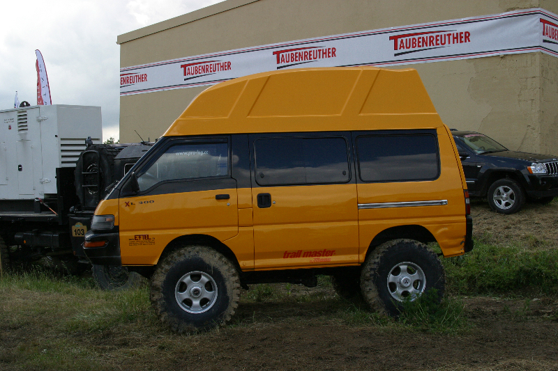

I would recommend not to go over a 2" lift as you run in all kinds of troubles if you go higher. In terms of tires everything larger than 31" and you would need at least a 3" lift. I consider 33" as "too large" for an l300, depending if you have the large tires just for show or if you actually want to go on trails.

Here is a l300 with 33"s:
- IMG_3600.JPG (512.32 KiB) Viewed 6616 times
